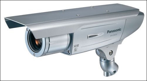

Arockerdude,
Don't know what your budget and application is, but have used this camera from Panasonic (WV-CW374) on a few of my sites. Only thing it doesn't have is IR ilumination.
Weatherproof Outdoor Use
Built in fan/heater
8x varifocal (5 - 40mm)
510 line resolution
Ultra-sensitive for colour surveillance in light
as low as 1 lux (0.1 fc)
Mechanical Cut Filter to B/W
Lolo Wolf - 11 Feb 2007, 10:34 am
Dave, that Pani Rapid is suggesting is a good choice, I used one with an extreme UF100, excellent IR response, you may want to look at the Extreme line as well http://www.extremecctv.com/home.php for your application there are a lot of cameras on the market with what you are looking for, really only dictated by your budget. You can also look at the Nuvico IR bullet line, cheaper used a few of those so far no issues but only recently installed them. I did like the outer ring adjusters and the iris control on the NVCC-HWE922IR42N-A. If you go with a D/N box cam in a enclosure I have had good results with Panasonic D/N line. Just buy a quality lens. If you are not married to box or bullets maybe you want to investigate weatherproof domes also, depends on your application.
