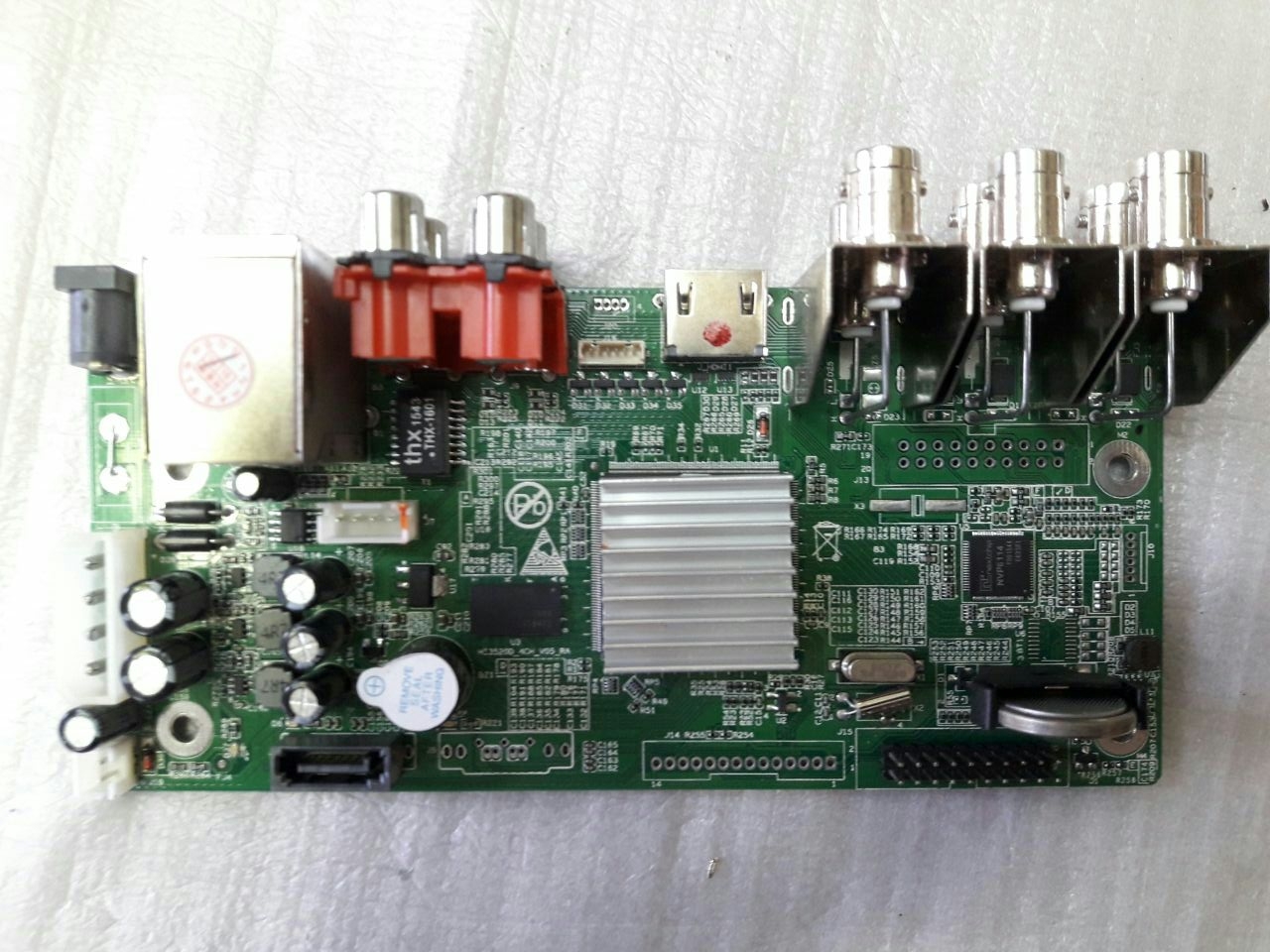

I bought cheap IP camera and NVR from aliexpress. Problem is that NVR can't discover IP camera in search section of NVR. When I set up parameters manual there is no any picture. IP camera give the picture when I connect to it by Internet Explorer or by mobile. IP addresses is in the same range, same mask, gateway. I can post link of this product on Aliexpress if it is appropriate.
NVR is T8300-4F Firmware is V4 20151231
camera is Sinocam 5033
Thank you
Hello,
[attachment=0]11.jpg[/attachment]
