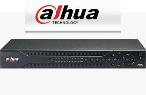

So I finally found some time to write a little about my setup and this DVR! :mrgreen: Upcoming are lots of pictures, of the setup and test images. Probably some videos too! I will talk about my experiences, show how I did things, etc...
Equipment for this system:
1x Qvis Zeus 8 Channel DVR (I've been told this is really a Dahua inside :D ), with 1x 1TB HDD
1x ESC3 TDN Vandal Dome
1x ESC3-WDR TDN Vandal Dome
1x ESC4 Vandal Dome
1x ESC1 TDN Bullet
1x No-Name Crap Camera (don't worry its a tight shot!)
1x Sony HandyCam Camcorder (big zoom was great for driveway, go ahead and laugh :) )
1x 1.2GHz analog TX/RX pair (for transmitting A/V from camcorder)
-CAT5E cable with passive baluns
-RF Modulator for viewing over home TVs
1x Generic Radioshack UPS
-Other odds and ends..
Believe it or not, I got a lot of this stuff for free... So I did quite well with cost, only like $300 total. The CAT5E is from my previous job, all the cameras I got from doing lots of testing, etc.
This whole system is not as 'serious' as the Cabin Job, but it really didn't need to be. I just wanted something solid and rather cheap to check up on the home, and provide a level of identification in case something happened.

So a bit about the DVR. By comparing to the Samsung I've installed this Qvis (Dahua) is very feature-full for its price! It has everything a basic/medium user needs. 8 channels at D1 with 7FPS on each. Audio on the first 4, lots of inputs/outputs, spot view, VGA out, PTZ stuff, great motion detection,lots of remote-viewing options etc. It takes SATA drives (only one of them) up to 2TB, and I put in the single 1TB 7200RPM drive from my Zoneminder computer.
Bottom line is, if you want a cheap DVR don't think for a second about going to Wal-Mart/Costco/BJs. Buy this thing and you will be very happy!! For under $200 I don't see what else I could ask for. What I think is really cool is this feature advantage continues up-the-line with Qvis, you can get real-time D1 DVRs up to 16-ch for great prices as well.
The Qvis line certainly is not as robust as the Samsungs, (remote viewing is not quite as intuitive), and the DVR interface is not as full-fledged. But hey, its such a deal.
So after installing the HDD, I booted up and set up the basics. Everything was easy to find. I have found the motion detection to perform very well. I currently have it set up to jump to the camera with motion inside a 8-view (1 big, 7 small) so that when I tune in with my TV I can see whats going on easily. Then after 8 seconds of inactivity, it goes back to a 9-view (1 screen shows recording bandwidth). I achieved that by enabling a Tour after 8".
For recording settings, all channels are D1, with 2 unused channels at 3FPs, the Driveway cam at 10FPS, all others at 7FPS. CBR is set, at max quality. Two channels have audio, the Driveway and Garage via a small microphone board I ripped out of a no-namer. Its nice because I can hear everything going on outside while sitting on the couch!
