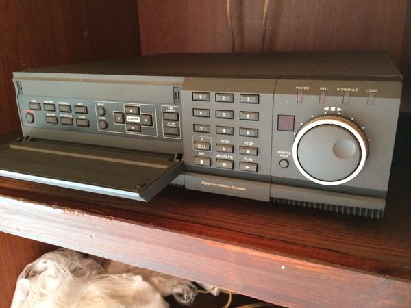

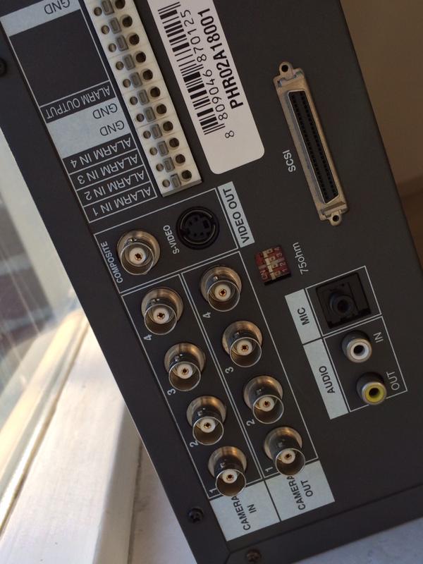

7208HWISH is a DVR, not a NVR. So it works with analog cameras and microphones, not with IP cameras.
That means, the audio is not in "the camera location"; the audio will be wherever you install the microphone, and the speakers (which might be near a camera, or anywhere else).
