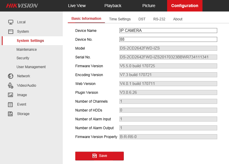

I doubt you will be able to flash it with Hikvision firmware. Hikvision is attempting to stop this practice.

Hi. No you can no longer flash hikvision English software from this October. If you buy trendnet you can't flash with hik

Would this be an issue with the TrendNet cam as its using a different firmware (no Chinese gov backdoor?) and apparently according to y'all you cant flash it to with the asian one?
Is there even any advantage of using the Hik firmware over the Trendnet one if you could?
