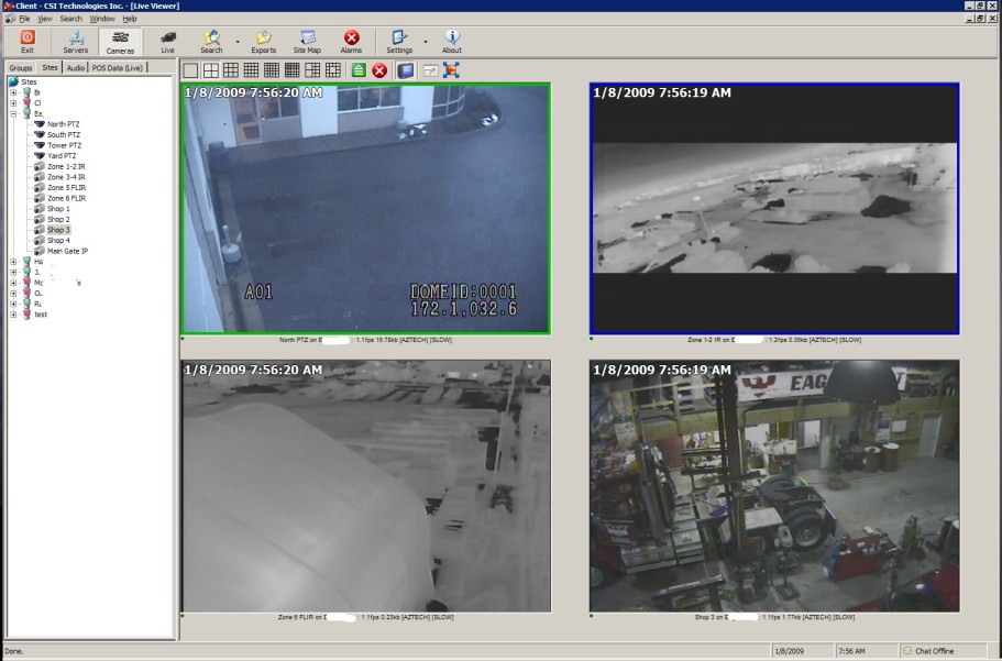

Soundy 1 Posted January 8, 2009 We actually have a few customers doing exactly this, using Vigil systems by Camacc/3xlogic. One of the main ones is a series of pubs and liquor stores - three of them, each with a Vigil DVR and a mix of analog and IP cameras, and the owner sits with the Vigil Client on his laptop and checks in on his stores The other big one is a major restaurant chain that used to do this with GeoVision DVRs; we recently took over the account and sold them on the Vigil systems when we did their new flagship store, we've since replaced a few of the GeoVisions with Vigils, and will be putting a few more in some new installations. They, too, are running a mix of IP and analog cameras. The Vigil Client allows you to configure multiple sites and create "groups" of cameras to view selected cameras from different sites on one screen. It also allows full search/playback, and supports remote PTZ control. This is the Client on my machine here, with multiple different clients' servers configured: This is a "Group" I set up for the pub/liquor store client; for those familiar with the geography in the Vancouver, BC area, the first site is in Surrey, the second is in Maple Ridge, and the third is in Downtown Vancouver: Internet on these sites is mostly via cable-modem, although a few run DSL. Haven't noticed a significant difference between the two, except that the local telco's DSL service has a tendency to change IPs regularly unless you pay extra for a static IP. Speed is good enough that PTZ cameras can be controlled near-realtime with relatively little lag. Share this post Link to post Share on other sites
