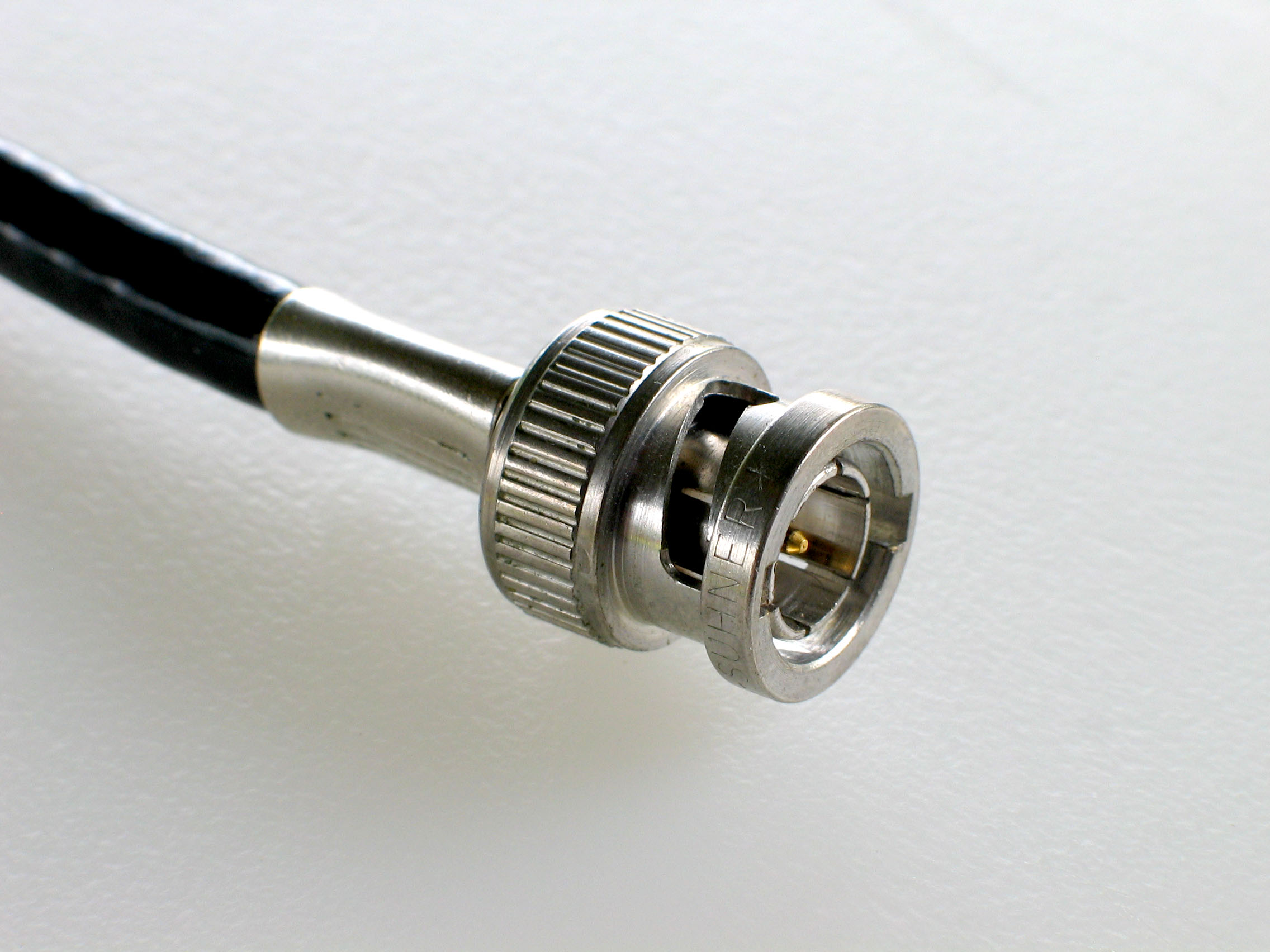

Soundy 1 Posted August 9, 2012 BCS? Or BNC? Does it look like this? If so, you need either some sort of video capture device to connect it to the computer (USB adapter, DVR card, tuner card, etc.), or an IP encoder to share it directly on the network. Share this post Link to post Share on other sites
a13ahl 0 Posted August 10, 2012 Yes, but the pin comes out of the head. The pin is longer. Share this post Link to post Share on other sites
Soundy 1 Posted August 10, 2012 Can you post a picture of it? I have a feeling it's still a BNC, maybe just not properly assembled. Either way, you need a capture device or network encoder to do anything with the signal... Share this post Link to post Share on other sites

Soundy 1 Posted August 10, 2012 That's an F-connector, common for cable-TV and satellite, not so common for cameras. If it does indeed go to a camera, you'll probably first need an F-to-BNC or F-to-RCA adapter to be able to connect it to a capture device. Share this post Link to post Share on other sites

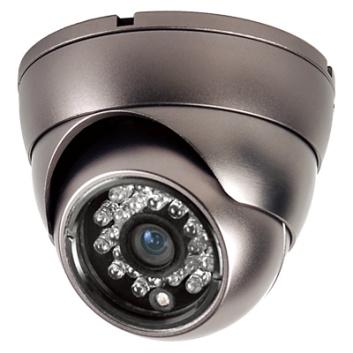

a13ahl 0 Posted August 11, 2012 That's an F-connector, common for cable-TV and satellite, not so common for cameras. If it does indeed go to a camera, you'll probably first need an F-to-BNC or F-to-RCA adapter to be able to connect it to a capture device. Yeah, that connector is typically for cable TV and stuff. Often run on RG-6 cable. As Soundy suggest, if it really does go to a camera, you will need the converters, and a DVR to connect it to. But just 1 camera? Yes, it is just one camera, it is a CBZ CDOME011/B that came with our house. Share this post Link to post Share on other sites
tomcctv 186 Posted August 11, 2012 Hi. yes its just a standard camera. with having a F connector it may have only been used for live viewing. just connected to a modulator then into your TV distribution (which is in your picture) but the last owner may have taken the modulator. are you looking to record with this camera ?? Share this post Link to post Share on other sites
