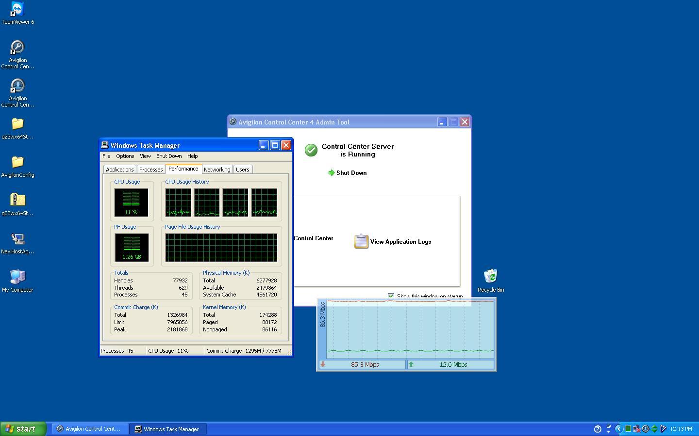

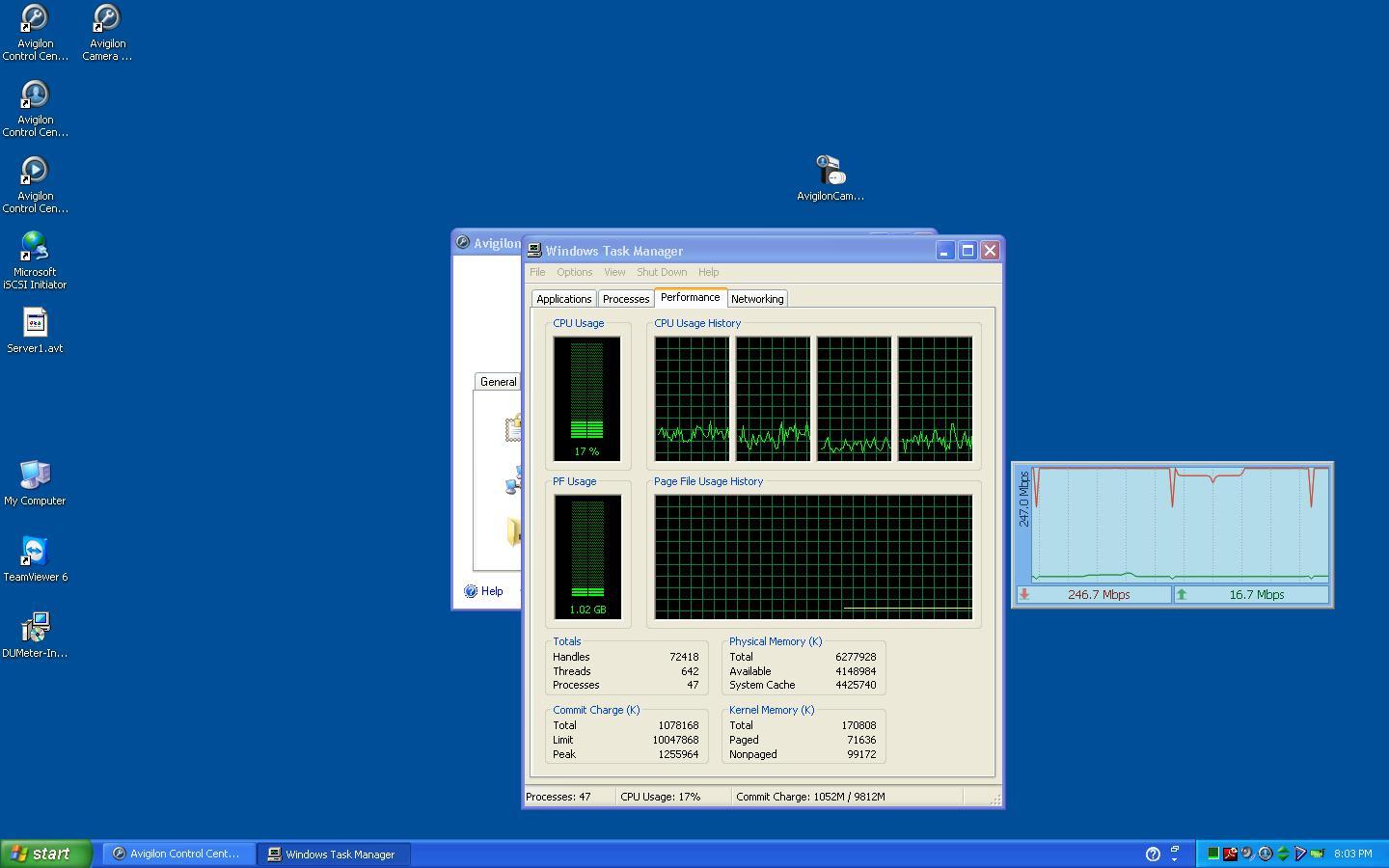

ssmith10pn 0 Posted March 21, 2013 My previous example was for older analogue cameras encoded using axis encoders. Connected on its own network. If I went with standard avigilon acc server software how many cameras would each physical server take. Do you need the server licence for each additional server or is it a licence per server? The license is per camera not per server. You can have 24 licenses spread across as many servers you want. On Production servers we shoot for a total bandwidth of 256mbps total throughput so obviously your question is more complicated then how many cameras. It could be 20 5mp JPeg 2000 cameras at 5 frames per second. It could be 24 encoders at 10 frames per second and 10 1mp cameras at 5 frames per second. How much live viewing? That all counts towards the 256mbps If you have a client with 4 monitors with 16 cameras on each monitor that can be significant How many cameras per sever is an open ended question with lots of variables. Normally I install DU meter and watch the total bandwith and add cameras until I either hit the limit or run out of storage. Since they are recording by motion detection that plays a huge roll in the storage demands. Share this post Link to post Share on other sites

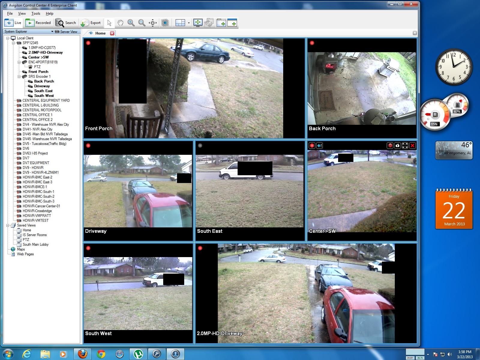

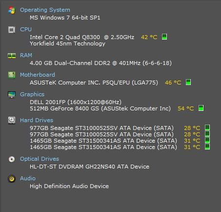

ssmith10pn 0 Posted March 21, 2013 I'm actually running Avigilon Server on My desktop at home along with the client. 2 4channel encoders 1 2mp H264 1 2mp Jpeg2000 1 5mp jpeg2000 1 1mp jpeg2000 4 1/2 TB of storage and I have recorded video back to December. Share this post Link to post Share on other sites

Kawboy12R 0 Posted March 21, 2013 ssmith10pn, nice real-world numbers there, thanks. Looks like a nice hybrid setup on a less-than-current computer. I see the CPU temp but that's just running the server, not the client displaying all of the cameras, right? What's CPU utilization (ballpark) with lots of recording and displaying all cameras? 10/100 switch? Plugged into the router or its own NIC on your server? Sorry to the OP for the semi-hijack although this is more or less on topic. Share this post Link to post Share on other sites

ssmith10pn 0 Posted March 22, 2013 ssmith10pn, nice real-world numbers there, thanks. Looks like a nice hybrid setup on a less-than-current computer. I see the CPU temp but that's just running the server, not the client displaying all of the cameras, right? What's CPU utilization (ballpark) with lots of recording and displaying all cameras? 10/100 switch? Plugged into the router or its own NIC on your server? Sorry to the OP for the semi-hijack although this is more or less on topic. It's raining currently, So recording should be full tilt. See if this helps. Share this post Link to post Share on other sites
ssmith10pn 0 Posted March 22, 2013 My downstream on my desktop with the server running and the client running is 34Mb I had it on a 100mb switch. I am paying for a 50Mb internet connection and I was only getting 19 on speed tests. I changed over to gig switch and now I get my 50Mb internet otherwise It worked fine at 100Mb I have Bitturrent running also Share this post Link to post Share on other sites
ssmith10pn 0 Posted March 22, 2013 Just checking to see how the network architecture handled things, regardless of theoretical good/better/best. That fair Seriously in " true" and not so true corporate environment any decent IT person will not want Cam traffic to be on the same subnet and with Avigilon it get even more simpler You do not have to have DHCP and Do Not have to to assign IP to camera just pure magic My home environment is all the same subnet with 2 SG 300-10MP Cisco Switches Just for kicks and giggles my neighbors DVR went out so I'm going to stick a encoder down at his house and link it back with Nano stations. Now on the corporate side we do secure Vlans mostly with HP Pro Curve Infrastructure. I have one hospital that insisted we ride their network (with a seperate Vlan). They use Nortel (Avaia) 5520 48port poe gig ports and 4 SFP ports. and 8600 core switches. They are now asking for a proposal for putting all the video on a separate system because when their IT department jacks up the system they loose live video in some critical areas and thats not an option. They had a company come in and update their core switches during a scheduled 8hr downtime. 36 hours later we were still troubleshooting pockets of outages because the ARP table got corrupt. Share this post Link to post Share on other sites
