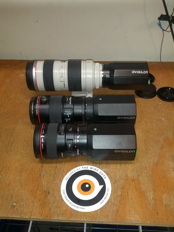

thewireguys 2 Posted July 18, 2013 Haha... Everyone is using my photos Share this post Link to post Share on other sites
buellwinkle 0 Posted July 18, 2013 It's a great photo. Share this post Link to post Share on other sites

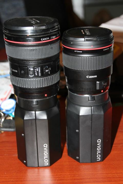

thewireguys 2 Posted July 18, 2013 This one is better Share this post Link to post Share on other sites
ssmith10pn 0 Posted July 18, 2013 Is that top one the Cannon 70-200? Share this post Link to post Share on other sites
