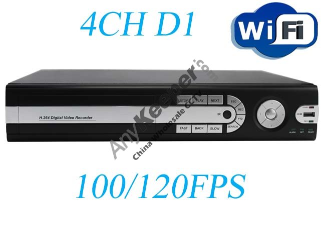

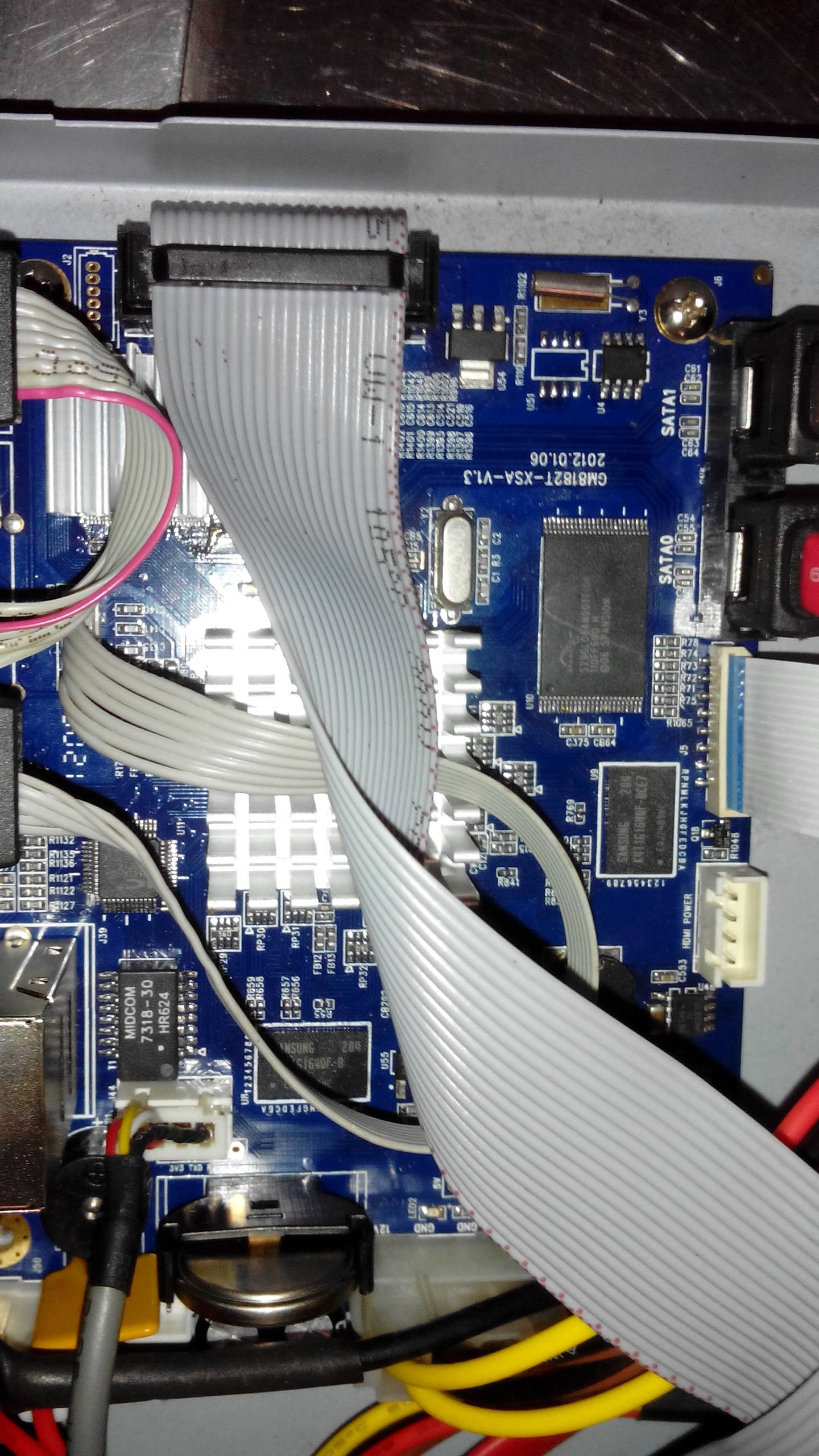

arnold123 0 Posted January 6, 2015 (edited) hi. please tell me how to reset the password on the rating given device. protruding battery gave nothing I think the model of DVR anko ak-5704 4 channel it in the image ak-5404. The default password is blank. There are two profile admin and guest ,here such interface. Number mat. board GM8182T-XSA-V.1.3 version of v.01.00.00.11 complete cms Edited January 7, 2015 by Guest Share this post Link to post Share on other sites

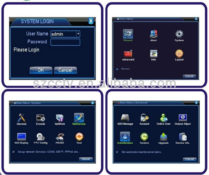

iTuneDVR 2 Posted January 7, 2015 Make login screenshot! Share this post Link to post Share on other sites
arnold123 0 Posted January 7, 2015 Make login screenshot! replied in the cap Share this post Link to post Share on other sites
iTuneDVR 2 Posted January 7, 2015 Password for 2015-01-07 is y7SJJC Share this post Link to post Share on other sites
mireesa 0 Posted January 9, 2015 Conect dvr to pc Then input dvr ip in internet explorer after instaling actvex And show login screen insert username guest and password is blank Login then go to remote seting and will change admin pass When change pass quickly login from dvr with admin and changed pass via pc as guest After sucses login to dvr go to change password Finish This method is working but when you know guest password Default guest password blank Share this post Link to post Share on other sites
