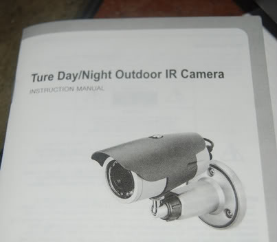

I ordered some ICRealtime gear for testing and it just arrived. I have posted a web album of equipment pics.. camera image pics to come:
http://s63.photobucket.com/albums/h135/jtreibick/icrealtime/
My initial impressions

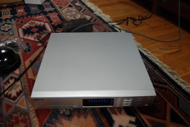

Max 16 DVR
While this unit is labelled 'slim' (only 2u) it is by no means small and is slightly deeper than it is wide (19")
With no assistance from the manual I fired this thing up and had several cameras up, running, and recording in no time. I ran into some trouble attempting to logon to the playback menu at about 6:30 eastern time after ICRealtime was closed. I immediately began to understand the limitations of the OEM product I was using after trying to sift through the unclear, poorly translated manual which clearly was not written by ICRealtime.
After plugging in the mouse I was able to logon to the menu system which was clear, easy to navigate, and overall pleasant to use. Recording/Playback quality was excellent even on the default 'medium' quality setting. Both the live local and network playback had very little latency (an important requirement for my customer.)
EL-720 Mini dome w/3.3-12mm autoiris lens 12vdc/24vac
IC Realtime dubs the EL series as their professional level dome. This surface mount dome has a local video out and on screen menu with shutter, color, white balance control and more. At a quick glance I noticed the low light performance was weaker than expected. Also this thing got hot... almost too hot it seemed. I had this hooked up via a regulated 12v power supply I thought I might have reversed the polarity (I didn't) but could not troubleshoot the problem. Later on when I reconnected this camera the heating issue seemed to have resolved. This concerned me, but I could not recreate the heating issue I first experienced.
EL-400 3.3-12mm WDR Dome 12vdc/24vac
The wide dynamic range of the PIXIM sensor was immediately apparent when I pointed this towards a window. I noticed it had the best low light performance without IR of every camera I tried out. The EL-400's design makes it look like it is recessed flush mount camera even though it is mounted on the surface, very nice. The default autoshutter settings on this camera at a medium to low light made motion appear less crisp than on each of the other cameras.
ICR-300H2 12V
This camera heavy duty construction was a stand out feature. At first I thought perhaps I made a mistake and ordered an outdoor dome. This camera could be classified as a 'dome' but its really more like a "squished orange" bullet with a tilt surround covering. It seems more friendly than a bullet, but you can still see where the camera is pointing. The zoom and focus options are accessible via small screws on the front of the dome. Because this is in the value 'IC' line vs the elite 'EL' line there is no 24v power option, local video out, or adjustments of the sensor of the camera.
I liked this thing, it outperformed my expectations for picture quality. ICRealtime was able to get me a deal that was comparable to the cost of the ICR-200, but this has zoom.
EL-1000 Outdoor IR Day/Night
Still need to test this one out. Solid bullet construction and zoom.
Single detachable wire from the back.
Overall
The DVR met my expectations, the bad documentation was a little off-putting, but there was nothing that stuck out as being a show-stopper. The cameras were a mix of under and overwhelming.
Camera images to come.
