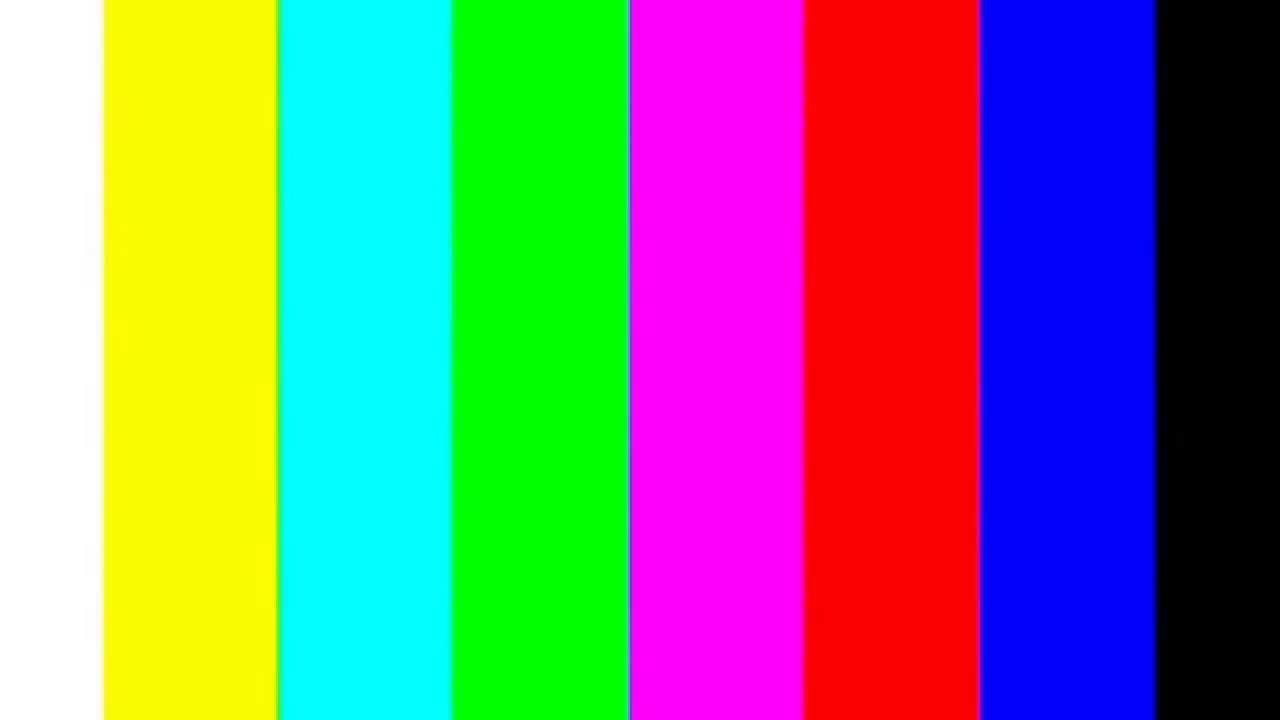

can any one shed some light on the got another dvr and this one only showing colour strips on screen going top to bottom the first boot screen thanksHi what type of strips ?
Is dvr new or old......?
just like you pic and its a old sunluxy one 5l-d1o8
Yes that could also be a problemThat would not give the problem you have with vga...... did you check PAL NTSC
it was set to pal so swoped it over to ntsc still the same then back again i think iv got 1 a bad hdmi port and 2 a bad graphics processor
o-wh_Lpv5FIHi a few tests ..... what happend when you startup with no cameras attached.
What happends when you startup without the Hdrive connected
Also how are you connecting to monitor
hi thank you its the same with or with out hd and same with or with out cams
and if i run it throw the vga it locks like loads of squares very blocky like a old pc with no graphics
Does it stay on via vga ?
Lots of squares and blocks is also a sign of being on wrong format
PAL or NTSC ...... try changing it ...... menu on dvr
