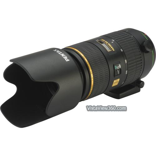

Looks like you're getting a flare from the light hitting the front element of the lens. You could try putting a piece of paper (something thick and black would work best) over the lens to block the light from hitting the lens element... if that helps, you can make something a little prettier.
Think of the sun hood on an outdoor enclosure, and adapt that idea to a smaller scale to fit your lens:
Picture the lens hoods you can get for SLR lenses, for example:
