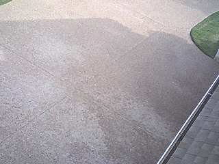

Good question - I don't know for sure that it's the PIR or video motion detection that's tripping, but review after-the-fact of the video capture after the motion was detected doesn't show any motion - at least to my eye, which leads me to believe it's the PIR that is tripping. Below is the view from the camera. It's a pretty tight view and I would think it would be obvious is there is any visual motion.
Do cameras like this typically have the PIR sensors active during the daytime as well? I ask because I seem to have more false alarms during the daytime, and if the PIR sensors are typically disabled during the daytime, then that would point to some funkiness in the video motion detection.
Maybe the view is so tight that the subject has already left the field of view? Is there an option to capture pre-trigger frames? I use built in PIR motion detectors on Mobotix, AVTech and Axis and they all work very well as one would expect.
Is the light level changing from clouds passing? That'll trip video motion detectors. Also, it helps to view a zoomed in image (thumbnail no good) to see if the cam is doing any picture adjusting of its own. Auto iris, compression (look for blocks of pixels changing a bit), or whatever other reason. Also, look to see if there's any way to show a motion detection video overlay to visually display a flashing block, red square, or whatever on the screen for areas that are moving enough to be triggering a motion event. Also, is there some way to distinguish between video motion and PIR events in your recordings? That'll narrow it down. If it's definitely PIR, then you might be picking up passing cars, pedestrians, or whatever.
