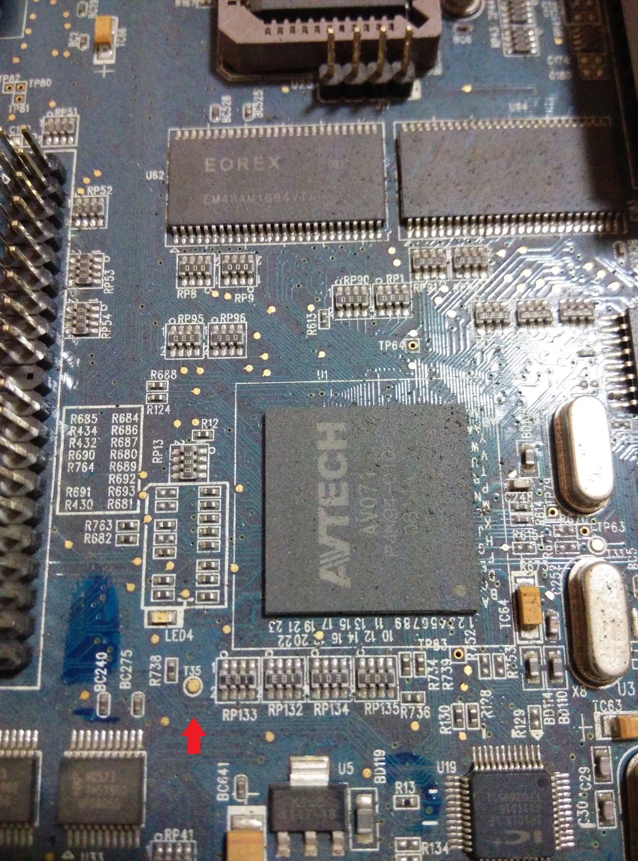

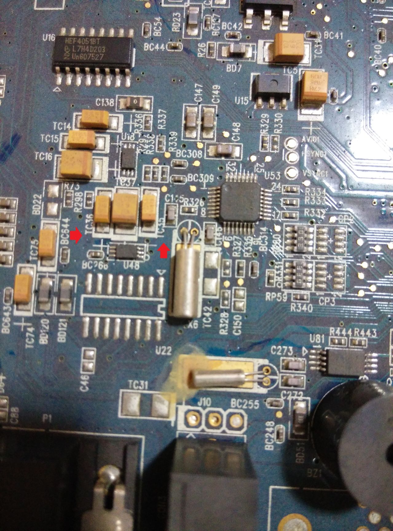

Point t4/t5 near qc stiker
Sir i tried shorting T4/T5 i hear 1 beap for less than a sec when i connect the power cable
after reboot i tried admin admin , admin password , admin 0000 but still invalid password , kindly help
is my shorting procedure correct ?
First short and then on the power (long beep hear and dvr restart (still short and power on) utomatically
sir , i turned off DVR-removed PLUG
Shorted T4-T5 with Metal CLip
Holding the wire firmly i pluged LIVE power cable
i heard single beap ( i think its normal beap)
waited sometime
Removed Metal clip
powered off the device
turned on , still same
U R MY Live saver , it worked , it reseted to default IP 192.168.1.10
admin
admin
thank you vm
