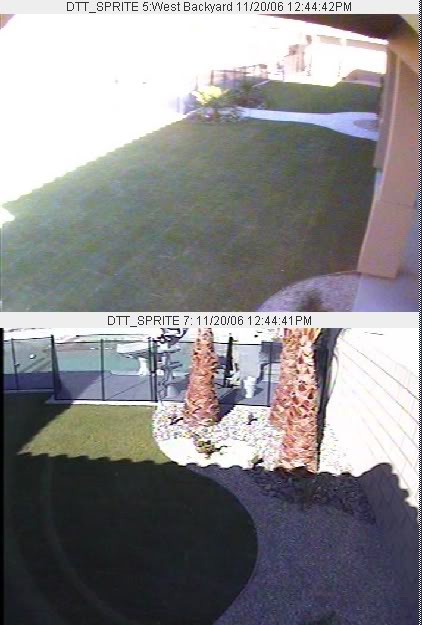

Well I got the KT&C WDR PTZ in on Saturday and installed it.
Here is a comparison. Please note the following.
The Top camera is on the West side facing East, the bottom is East Side facing West.
Also the Top camera is a nuvico. What this does show is the HUGE difference in glare. You cannot even see the shape of the pool, never the less, the water. Plus also note that it is noon time...so the sun is directly above, so there should be no difference in east to west glare.
The WDR can see the water color etc. The reason it is not totally on the pool is that it seems my DM Sprite 2 cannot do Pelco - D protocol which is what that camera is. Another story for another post.....
But anyway, HUGE difference.

Need to check the AI level on that Nuvico .. If you can turn that down, the image should improve greatly .. but also you will need a color monitor to adjust that... also turn off Flicker mode as that makes it brighter . and though I doubt it has it .. if it has SAGC turn that off (From SAGC to AGC).
Yeah but what im saying is thats not normal .. the Nuvico image .. its either a setting issue or a bad camera .. even the cheaper ones dont have that much glare .. looks like the Iris is open too much.
Which model is it again?

doesnt look normal. suggest adjusting the AI level .. we have tons of sunlight here and never see a camera look like that unless the AI level was not adjusted or it had SAGC turned on.
Its not that your sun is more intense its the fact that its looking right almost directly down at a area of contrast. One is bright and one is dark. So you can usually have one of two ways.
