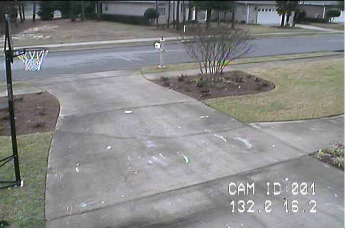

I'd considered getting a Mobotix camera for over my driveway (currently have a Surveilux PTZ there), but wasn't sure whether the VGA model would be good enough (was leaning towards the 3mp "mega" model). I have to say your VGA image looks much better and sharper than I thought it would... and much sharper than my 4CIF PTZ.
Can somebody shed some light on this for me?
*************** EDIT ****************
Here's a sample image from my driveway:
Thank you for posting your image. We can do a lot with that bit of information.
Here are some observations:
1. You see how the diagonal lines in your driveway are jagged/rough? That is due to an interlace (normal TV) camera sensor. In presence of slightest camera/subject motion/vibrations, you lose half your vertical resolution resulting in kind of artifact you see here. The camera or DVR software can filter these but then you get a softer image, not a sharper one. Advanced de-interlacing like used in better built A/V equipment does a better job here but I have not seen evidence of it being used in CCTV market yet.
The sensor in Mobotix is progressive and hence, has full 480 lines of vertical resolution.
Note that this kind of artifact makes the video harder to compress. So all else being equal, you also get more compression artifacts at the same data rate as that of a progressive sensor.
When picking an IP camera, it is super important to make sure it uses a progressive sensor. There is no reason (other than saving a couple of dollars in manufacturing) to use an interlaced sensor. I have noticed for example that some of the Acti IP cameras use interlace sensor (evidenced by the same artifact shown here in their demo material).
2. Cross-color/False-color visible in details. Look at the basketball net. You see the red/blue color bleeding there? That is an artifact of NTSC decoding not done right and/or fault of the NTSC format itself. same thing is visible in the bush branches near the mailbox. There, you see that artifact combined with problem #1, making a mess of that object.
Analog comaras sending their NTSC signal over a single composite (coax) wire will have this sort of artifacts which reduces effective resolution of the image once more.
As with #1, the extra "information" (false color) makes compression harder resulting in either larger files (if data rate is allowed to be higher) or more artifacts (if data rate is kept constant).
Again, the progressive sensor in an IP camera is sending pure data and not subject to NTSC flaws that come from sending that signal over coax wire (as opposed to a fraction of an inch inside an IP camera).
3. I see more compression artifacts. For example, let's look at the camera captions. We see what we call "ringing." These are halos that get created at the edges of objects (the sharper the edge, the more you see them). On top of that, you also see problem #2 in them with false pink shades bleeding into them as the signal had to be modulated into NTSC and demodulated back in the DVR. This again makes them harder to compress.
I see a lot of "blocking artifacts" in the cement driveway. These are square blocks that show up when that segment of the video is overcompressed. Another manifestation is image detail completley getting destroyed when these artifacts get too high. Look at the line at the intersection of the driveway and road. That line is barely visible. It is destroyed by combination of all three factors explanied here.
Grass is very difficult to compress and here, we see them becoming a sea of little blocks/blurriness, taking away their nature texture. On this front, I would say your image was harder to compress so on this bit, I think the comparison is not quite fair.
Partial olution for #3 would be to boost your data rate/quality setting. Set it way high for testing and you should at least eliminate problem #3, leaving you with #1 and #2.
4. NTSC signal sent over a coax wire CANNOT send 4CIF worth of horizontal resolution. The system is not cable of doing that, period. So your image has lower resolution than the sensor would indicate. Again, Mobotix doesn't use NTSC so it can send all the signals as it sees them. See my post in the middle of the page here: http://www.cctvforum.com/viewtopic.php?t=10415&start=45 (how do you link to single post here?). You are losing nearly 40% of your resolution this way!
Net, net, this is a classic example of how well a progressive IP camera works relative to an analog TV. Unless you come and tell me your camera was also IP in which case, I have to make a visit at this company and teach them a thing or two about proper design .
Have you seen exceptionally good photos from a high-quality digital camera posted on the internet? The camera may be 10 megapixel or more, and then the resolution is reduced to VGA sized to fit on a web page. Photos taken with a high megapixel that are then down-resed typically look much much better than photos taken with low-end cameras with only a modest number of pixels.
There are other factors as well. Cheaper cameras not only have fewer pixels, but the pixels themselves may be very small, which means they collect less light and have more noise. In addition, high-end cameras typically have multi-element glass lenses, whereas low-end cameras may have plastic lenses.

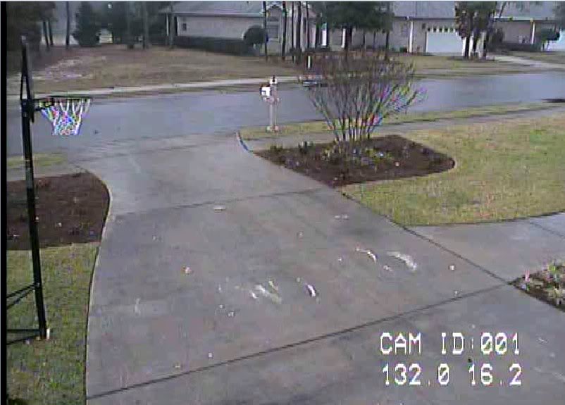

Just to add a second perspective, here's another screen grab from the identical scene, and the identical camera. This time, however, I took a screen grab with the camera detached from my embedded DVR and attached to an Axis 241q. Bit of a difference, wouldn't you say?
The Axis unit claims that it "de-interlaces" pictures. I don't know if that's an Axis euphemism for "progressive scan," but the picture is much cleaner through the Axis unit than through the DVR (a Dedicated Micros DS2).
Yes, big difference in reduction of compression artifacts.
The two terms are not interchangable. Let me explain.
An interlaced sensor sends the horizontal pixels the same as a progressive sensor. However, in vertical dimention, in one shot ("field") we get the odd lines, and in the next one, even ones.
Now, if the camera and subject are 100% stationary, then nothing is lost in using interlace. We paint the odd lines in 1/60th of a second and even ones at the next 1/60th of second. Your eye would "filter" these into thinking all odd and even lines were sent at once.
But life is not made up of static objects and rock solid camera mounts. As soon as either moves, the odd and even lines are no longer from the same image, but different ones (due to things moving 1/60th of a second later). If the motion is fast enough, your vertical resolution reduces from 480 lines to 240 lines (i.e. odd and even lines capture entirely different images).
So in a nutshel, our broadcast standard has a variable vertical resolution. For motion, it has half the resolution of static objects.
There are two solutions here:
1. Average the two "fields" and created one "frame" out of them. This would smooth the differences between the lines, replacing the jagged line with a softer, albeit lower resolution image.
2. Using motion tracking to attempt to synthesize what could have been there if we did not have interlace. This is hard to do right and hence my comment regarding it not being as common in this space.
I don't know which scheme Axis is using but neither is the same as having a progressive sensor at the start. Interlace is a complex transformation of the image and it is very hard to undo its effect after the fact. The ONLY way to avoid it is to use an IP camera with progressive sensor.
Having said this, the Axis is doing a nice job there.
