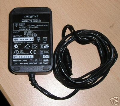

volatileacid 0 Posted February 12, 2009 (edited) That little Power Supply is more for charging up Cell phones, etc. You need to find a proper power supply. You are better off finding a Power Supply (12vdc) out of an old PC and using that. Use at least a 250 watt (minimum) size. At least they are UL Listed. Just put them in an enclosure to protect the wiring, etc. Here's a close up pic of the ebay adaptor I was! thinking of buying.... As you can see from the specs, it's outputting 12v @ 1.25 amps from this switched supply, it's not a cell phone charger that's for sure. As far as I'm concerned, it's capable of the task - what I need to consider, as others have said, is individual fusing, and chances of interference. If I had used this, I would definitely have got the fluke multimeter out to ensure it was outputting what it said it would. Edited February 13, 2009 by Guest Share this post Link to post Share on other sites

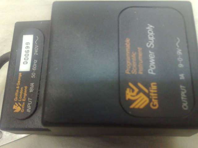

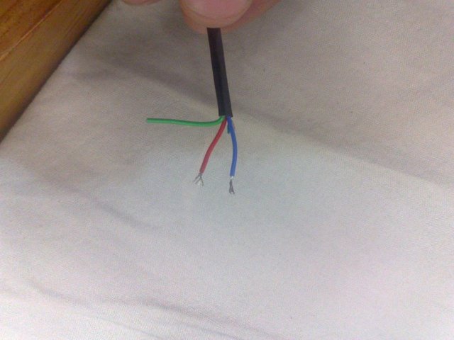

volatileacid 0 Posted February 12, 2009 Ah, the old "foil on the fuse trick"! An old quote says "If you use the wrong fuse, the circuit blows to protect the fuse". LOL Are you sure the pictures are of the same supply? The first one says Griffon and George and the output is 1A 9-0-9 VAC. The second says Creative and the output is 12V 1.25A. Hey Survtech - the Griffon was the old PSU!!! It was the one supplying the 18v! The second pic of the three wires was from the same psu also. The multimeter was giving me a reading of 18 odd volts AC from the red and blue wires! Share this post Link to post Share on other sites
cachecreekcctv 0 Posted February 12, 2009 Your Power Supply is really a transformer. AC voltage to AC voltage. Look at the symbol of the output voltage. The reason is reads " 9 -0 - 9 " is that one is neutral, and the other two are 9vac. You probably read 9 vac together on the other two leads, then 18 VAC betwen the two "hot" leads. I have many transformers like this. For other purposes, not CCTV. Look up "voltage symbols" or something like that. DC voltage has two lines, one solid, and one directly below that is "dashed". Yes, always be careful trying to substitute power supplies from one area or another. I build my own often, as I work with High Voltage equipment on a daily basis, and have since 1982 . I handle 480VAC on a daily basis, several times a day normally. If you lived closer, I would build you what you need, as my garage is full of electronic/electrical projects. Share this post Link to post Share on other sites
