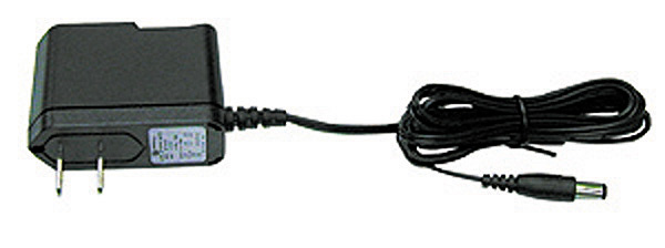

Easiest "fix" by far is just to replace the single power supply with a series of wall-warts. All the involved work takes place in a single location: the terminus of the Cat5 runs. Remove wall box, mount power bars as necessary, and splice existing camera power connections into transformers, one for each camera. The specs I found for the cameras calls for 310mA each, so if you can find a bulk-buy on 12VDC, 400-500mA adapters, you're laughing.

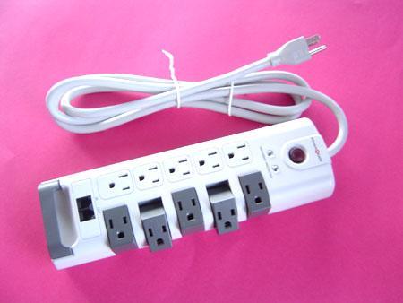

If possible, look for slim-profile types so you can cram more of them onto a power bar - like this one:

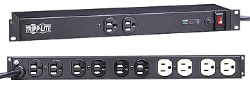

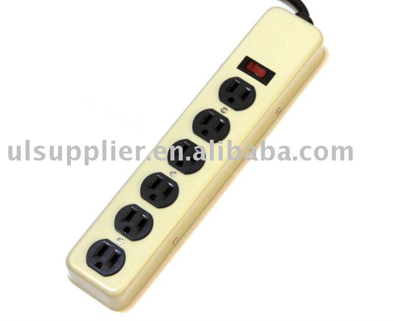

where would i get these power bars from?
Almost anywhere... building supply store, electronic store, department store, surplus store, dollar store...
I'm talking about these things:
Use whichever style suits your needs and space requirements. The top one would work fine with the power supply style pictured further up.
