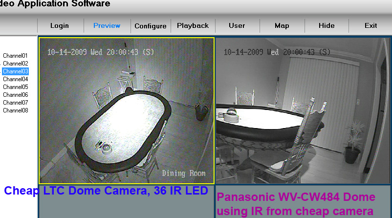

Here is a live screen shot from both cameras taken at the exact same time, looking at my back door. The room is completely pitch black.
The cheap LTC camera (left) has 36 IR LED's lighting up the room. The Panasonic camera (right) is just using the IR from the cheap LTC camera.
Here are the two cameras:
Notice the clarity of the blinds, the plant, and the wall on the left side of the picture. The wall appears grainy to the cheap LTC camera, and smooth to the Panasonic.
During the day time, the light coming in from the back door completely blinds the LTC camera, but the Panasonic deals with it very nicely. (I will try to post a screen shot of that tomorrow afternoon)
I bought two Panasonic domes (thanks WDRJack!) for the exterior of my house and was just testing them out tonight, playing around with them. Man, I'm spoiled now... I think I want some more for the inside of my house, and maybe just wire up a seperate IR illuminator.

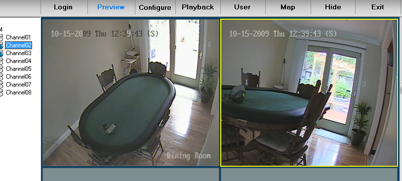

Well, wouldn't you know it... its rainy AND overcast outside, so I cant really test the cameras like I wanted to (facing my back patio door with very bright sun shining through). But here is a screenshot anyways.
Yesterday, when it was sunny, the LTC camera was totally blinded, and it was a big white blob where the back sliding door is. Today it isnt that bad, but you can still see the difference: The panasonic can actually see through the glass door, and see the deck outside. The LTC cannot. There are no lights turned on in my house. The room is lit up from sunlight only.
Also (and you cant notice it in this picture), but under certain lighting, the LTC colors are just washed out. For example, my hardwood floors show up a grayish color on the LTC, but the Panasonic shows them their true color, which is a deep, nice, brown color. Again though, not that noticable in this picture under these lighting conditions. The Panasonic reproduces colors very accurately. It's nice. Perhaps I'll post another screenshot when this rain goes away and the sun comes back out!

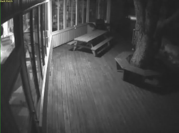

That Panasonic dome really shines at night. Here is a before-and-after shot. First pic is from an IR-equipped bullet cam... water spots on the lens, spider webs, etc.
The second pic is from a Pano 484S dome, with a separate illuminator:
all Day Night cameras (bullets included) are supposed to look at least as good as that second image, there is nothing special about it, except it was done correctly
