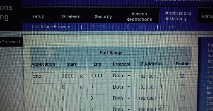

From the photos, it looks like this should work... making sure, of course, that you're specifying the proper port number on your browser's command line (eg. http://108.1.xxx.xxx:8000 - I assume you already have this figured out though, since you say you can access it on your phone's WiFi connection).
So we're back to the possibility that the DVR uses other ports besides what you set there for its communication... again, a way to test that is to enter the DVR's IP in the router's DMZ section.
You could also try adding the Gateway address in the DVR setup - this would be 192.168.1.1. It SHOULDN'T be necessary, but it won't hurt to try. Use the same address for the DNS entry as well.
Hmm, wait... looking at the picture again, there's a separate entry for "http port" in the router settings... port 8000 is likely for the data connection that client software (or a web app) would look for, but the initial web connection would need to be made on port 80, and from the sound if it, your router's config page is snapping that up. Try disabling "remote admin", or changing it to a different port, and then forward port 80 to the DVR, as well as 8000. Or change the router's HTTP port to something else, and forward that to it (maybe 88).

IN any case, it looks like you just need to have both ports 80 and 8000 forwarded to the DVR (unless you change those options).
That won't do it... you need 2 ports forwarded. One for web access, one for data. I always change web port usually to 90, and leave data port at 8000. The forward 90 and 8000 from router to DVR (192.168.1.102).
With only 8000 forwarded you would be able to use Hikvision CMS software, mobile phone clients, etc, but you would not have web interface for the DVR.
You also MUST configure the DVR gateway so it can connect to the internet, I guess it will be in your case something like 192.168.1.1.
To test my understanding, My linksys will have 2 entries (8080 and 90) in "Port Forwarding" both pointing to the same 192.168.1.102 ?
New pics: After fussing around the port forwarding is now 8080 and I did add the Gateway as discussed.
When I turn off DMZ, I can no longer connect remotely...
Thanks!
You also have to set the "HTTP PORT" in the DVR to '90' for this to work, and then use http://108.1.xxx.xxx:90 to connect to it remotely. Either that, or just forward port 80 to the DVR and leave everything else as-is.
80 is the default port for http, so when you tell a browser to use http protocol (by starting a URL with "http://"), it will try to connect on port 80. If you want to use a different port, you have to specify it.
Using port 90 won't make things work any better, BTW... it's simply a security measure to make sure if someone "accidentally" plugs your IP into their browser, they won't get your DVR by default. (It would also be necessary to use a different port if you're running a full webserver on the same connection).
