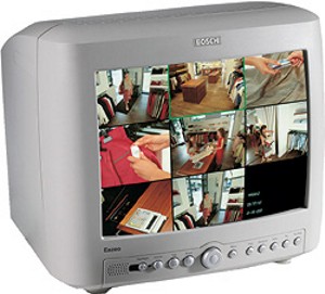

Hello members I need to convert the RJ11 ends of four Bosch cameras (from a Bosch eazeo system) to work on a new DVR with BNC inputs.
