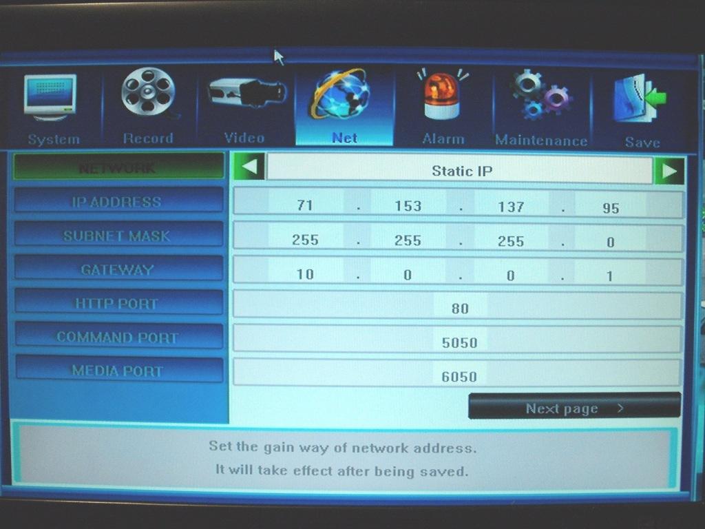

So here was my quest on trying to set up a static IP address.
1) I went to IP chicken and found out that my IP was: 71.153.137.95. I also confirmed this in my Routers Admin page. In a matter of fact, for your reference here is my routers status page:
2) So what I did was enter this info into my DVR's Net Settings, again here is a pic of what I did:

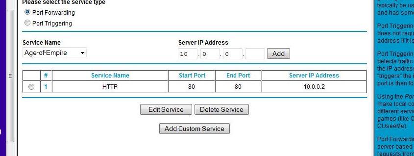

3) Next, I added a port forward on my router.
The router would not let me put 10.0.0.1 as the gateway so it automatically put 10.0.0.2. Some may be thinking well, you need to put 10.0.0.2 in your router then (I will get to that in a moment)

5) Next I changed the gateway number in my DVR to 10.0.0.2 and that did not work either.
6) Also, I tried changing the subnet mask in my DVR to 255.255.255.255 and then I save it but the DVR does not seem to save that setting because I go back into the DVR menu and the subnet mask setting reverts back to 255.255.255.0

make the DVR this:
IP = 10.0.0.200 (or whatever as long as the last part is more than the number of PCs on the network including any wireless PCs that might connect)
Subnet = 255.255.255.0
Gateway = 10.0.0.1
Then test that IP locally.
Once it works, then port forward the port/s the DVR uses to that IP address.
