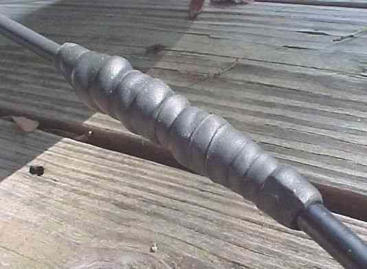

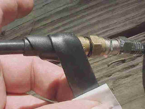

You can either use electrical tape or silicon self fusing tape. Make sure it's outdoor rated with uv protection. And for either tape, cut the last end of the tape at an angle (60 degrees) to help prevent the end from "raising" (lifting) up.

A tight wrapping of *good* PVC tape or a couple coats of "brush-on electrical tape" finishes the job.
