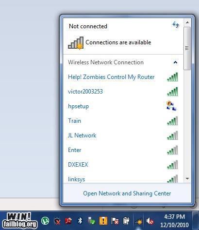

Sawbones 0 Posted January 18, 2011 That is full of win. Share this post Link to post Share on other sites
