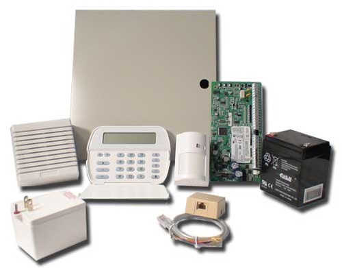

Here is a typical "starter kit", with the basics:
You can see the main panel, siren, motion detector, LCD keypad, backup battery, main pc5010 board, RJ31X (keeps thieves from disabling call-out by taking a house phone off-hook), and wall transformer.
Of course, you need a few more things, like sensors for all doors and windows (maybe garage too!), at least one glassbreak detector, maybe another motion detector, and of course 2 and 4 conductor alarm wire. I highly recommend an outdoor siren and strobe as well.

Its really quite simple.
-Basically, the main board (pc5010) gets mounted in the panel.
-Keypads and other modules get wired into to 4-wire 'key-bus' (RED, BLK, YEL, GRN).
-Individual sensors in each area are wired in series to different zones (one end in Z1, other end in COM, for example). You may wish to use EOL (End Of Line) resistors so that tampers can be sensed.
-Motion's and glass-breaks get 4-wire to them, 2 for power from AUX, 2 that act like any other sensor.
-On the left is your AC power in from the transformer.
-On the right is your telephone line connection, to go to the RJ31X jack. 2 wires for phone line from telco disconnect, 2 to go out to house phones. (This is handled in the jack, though, so it can be easily disconnected while keeping the phone lines working).
-PGM outputs can be used for additional sirens, maybe to switch a relay, anything really.
-Bell output for connecting a siren.
Programming is rather simple. Save yourself a headache and get the LCD keypad, its a lot easier to use.
So here's a little intro into programming... To get into the programming mode, I enter *8 5010. It will beep, and red light turns on. 5010 is the default installers' code. ALL settings are inside 'sections'. Now lets say I added a second keypad. I need to register it with the system so it can detect if its tampered with. I will enter 902 to go into section 902 which enrolls all the modules. Let it sit, it will find all keypads and modules.
Now lets say I want to set it so all keypads will keep their screens back-lit so they can be found easily when coming home. Press to get out of section 902 (if necessary). Enter section 016 by entering; 016. Different numbers may appear. These show options that are enabled/disabled. To enable keypad backlighting, enter 5, which should come up on the screen. If we are done with everything, press # until the red light goes out.
