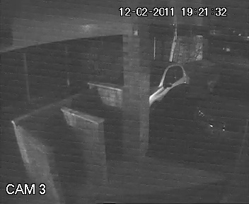

board camera screen rippling horizontal bars
I have installed an Eneo board camera into a vandal-resistant housing less than 21ft (of cat5) away
from my DVR. I have diagonal bars rippling across the screen although the clarity is quite good otherwise.
The power is supplied through a regulated 12v 9 x output box which in turn is supplied by a dedicated
spur from my electricity distribution box. Another camera supplied on the same PS shows no ripple so I doubt
this is a ground loop problem especially as the PSU is brand new.
There is a good chance the PSU is not the problem and I don't think there is a ground loop problem.
I am going to remove and re-connect all my connections tomorrow in desperation.
Any thoughts or suggestions would be appreciated. WHY ME?
It can still be a ground loop, if a conductive part of the camera body is attached to something metallic and grounded.
Beyond that, the picture almost looks like it has a "ghost" image, like it's getting bleed-over from another camera or video source.
There's no grounded part to the camera end I checked again just to be sure. It is mounted to a brick wall with plastic wall plugs and woodscrews.
If it is as you suggest, bleed from another channel, would that be a fault with the DVR or the passive baluns or even running cables together?.

If its not too much trouble - check to see if the cables run near/along side electrical/phone/catv wiring. All of these could cause that too. I have a camera that used to run along side a phone line, when the phone rang, the picture would get running lines like that!

Yes, the power to the PSU runs in some conduit for about 3 ft with the cat5 cables so I'll run it away from them and see if it makes a difference.
Re-wire the connections at both ends and replace the passive baluns.
Run the camera in isolation i.e. remove the other camera and run this one only (to see if there is any issue with channel bleed

Fact is that as soon as the cat5 cables enter the house they pick up a dedicated electricity cable
which runs with them to the DVR and PSU. To remove the power cable will involve a lot of re routing.

FAULTY POWER SUPPLY CHAPS
I was so careful and meticulous in my wiring because of the upheaval I had to go through to re run wire or re-do connections.
I knew that it had to be something new. The only new element I introduced was a new dedicated electrical spur and a dedicated PSU.
Having removed the mains cable from conduit running all the cables, I removed one camera from the PSU wiring it to another PSU
and bingo the picture has stopped rippling for that camera.. I then powered down and introduced the other camera to the same PSU
and neither camera picture ripples.
Today's Lesson
NEVERassume if sonething is new, that it is not faulty.
Here endeth the lesson.
Thanks for all your suggestions chaps it at least gave me a direction. I have telephoned the PSU supplier and they immediately accepted the PSU must be faulty and offered to replace it.

On the camera in question, cat5 cable was used, (interior grade) with a pair of passive baluns as the run was only 7 meters.
The camera in question is an Eneo board camera 600 TVL and the picture couldn't be better now. Razor sharp in fact.
