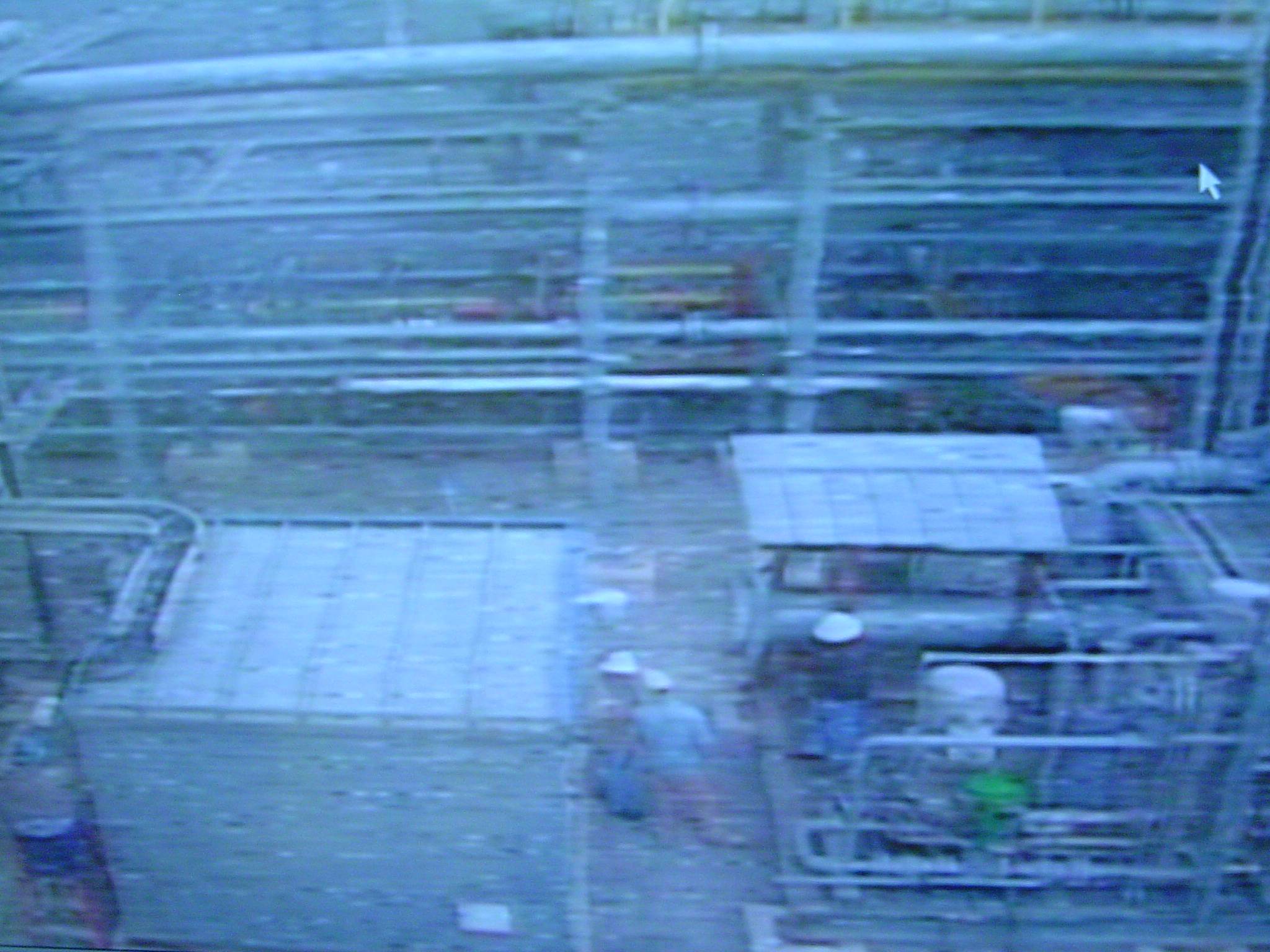

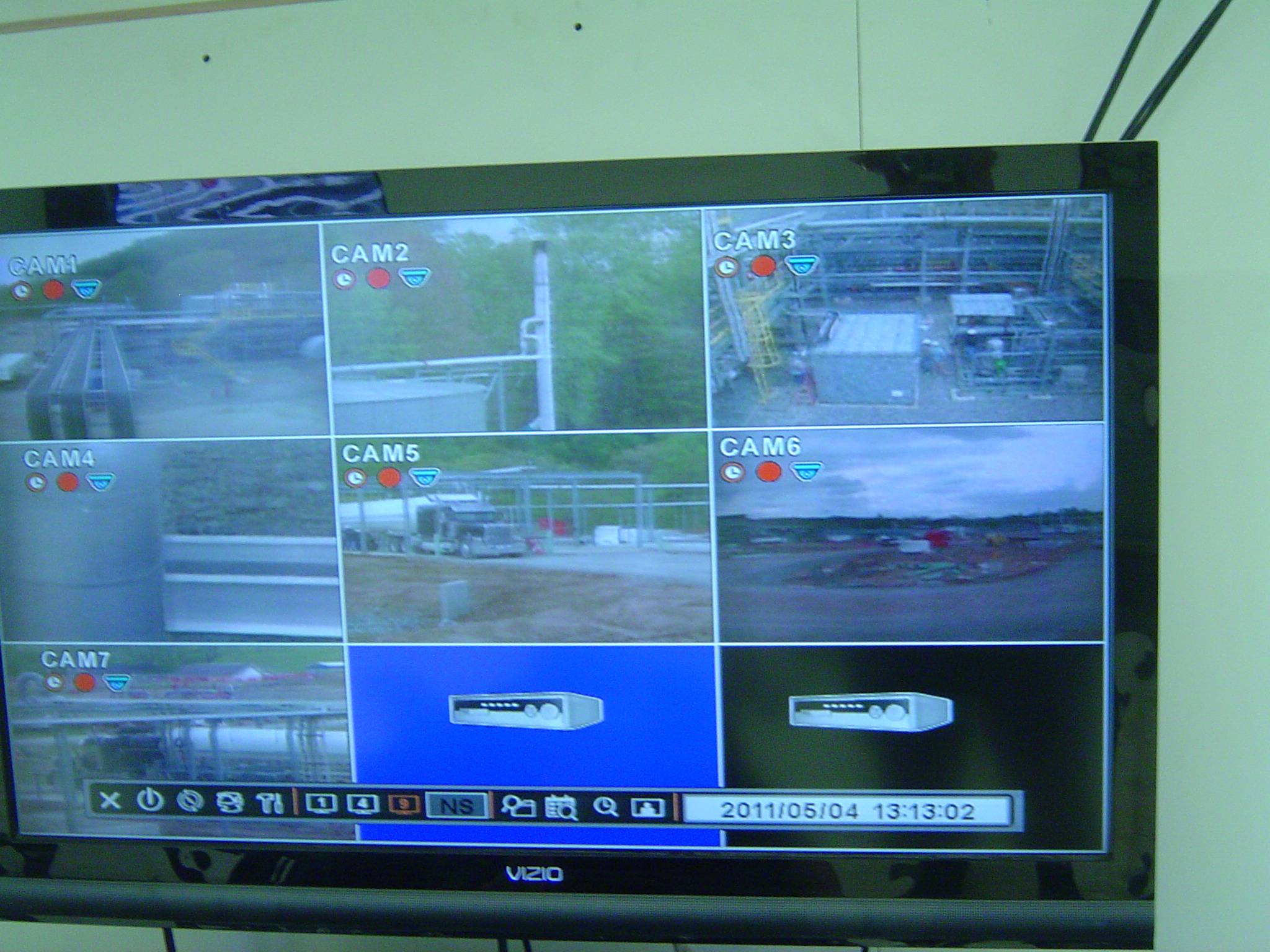

Some (rather poor) pictures of the interference seen on the viewing monitor can be found below:

That first photo looks like motor noise of some kind - not what you'd get from running too close to power lines, but what you'd get from running too near an electric motor or something of the sort. I've also seen similar interference from RFI caused by a car's ignition system, but since the noise follows the operation of some equipment, I doubt that's the case here.
Actually, my uncle used to have a CB radio in his Jeep that would cause similar interference on a certain TV channel when transmitting on a certain CB channel... does any of this equipment use RF-based controls or telemetry?

Judging by the pictures (w/o seeing them moving is difficult to see) but it almost looks more like a ghosting problem...?
