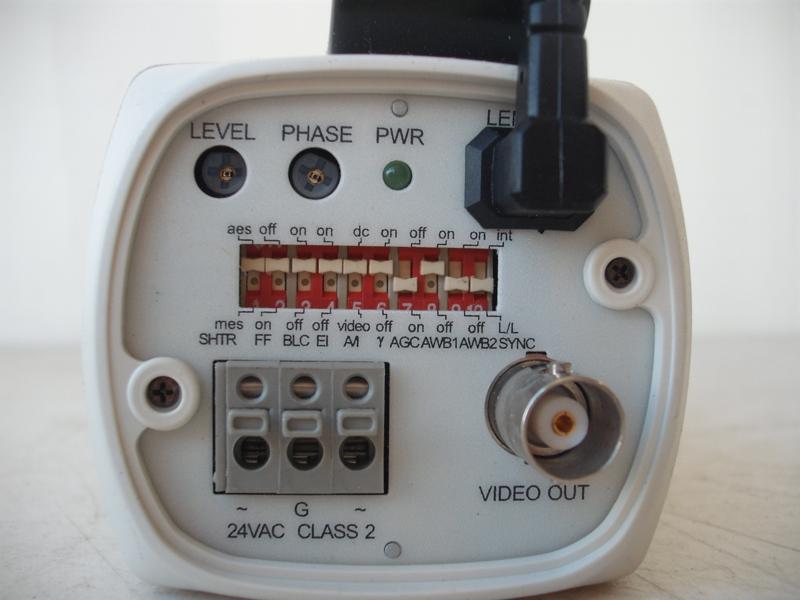

Yes, there are also lots of cameras that operate on ONLY 24VAC. This particular one looks suspiciously like a National Electronics NLC-5700.
