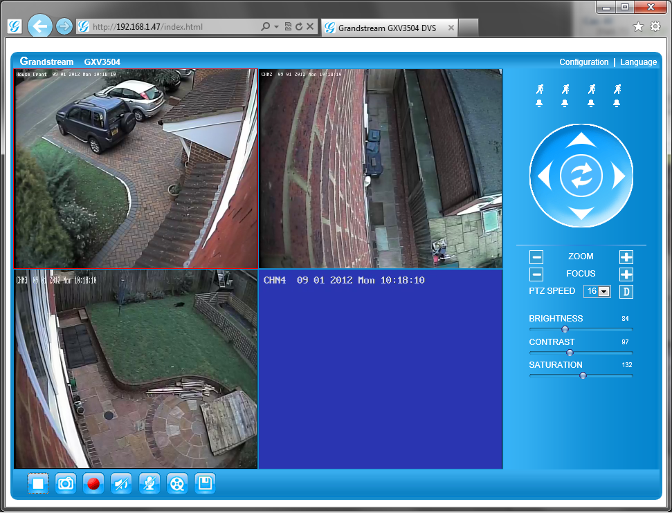

However in the meantime I investigated an OS-independent solution, that is, an IP video encoder. After reading up I bought a Grandstream GXV3504 4 channel which encodes at D1, and does the cpu heavy-lifting of motion detection, etc. To store the captured video I set up an FTP server on the WHS server, and configured the Grandstream to FTP video over. It works really well, with a serious improvement in video quality over a cheap capture card, and it doesn't tie me to a specific OS for driver support. I can also access live video and recordings from any PC using a web browser.

Can you get the 4 video streams independently from a browser, or do you have to use the Grandstream app?
I can certainly use VLC (open RTSP) to live view channel 1, which implies Grandstream are at least exposing a standard H264 RTSP stream. However I haven't bothered to work out how to access the other channels yet, as I generally use a browser (IE) as shown above.
Although maximising the browser window does not increase the size of the images, I've discovered that increasing the text size (using keys: CTRL+) makes IE nicely scales up the images too. And, if you double-click an individual channel image it becomes full screen (no title bars or start menu).
