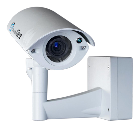

Is there anyone besides Arecont that makes a 5MP bullet camera.
I received a RFQ for 5MP bullets, 3MP domes, 1MP domes, 1MP domes with WDR and trying to find one manufacturer for each of these without having to use two or three different camera MFG's.
Run on ONSSI and 90 days retention at 7FPS!
Thanks for any help
http://www.iqeye.com/products/sentinel-series.html
IQeye Sentinel Series Features
- Resolutions up to 5 MP
- Remote Back Focus for Sharp focusing (IQ86x Models)
- H.264 Main Profile + MJPEG
- 30 fps @ 1080p, 10 fps @ 5 MP
- Day/Night Moveable IR Filter
- LightgrabberTM II Low-Light Feature
- 3-Year Warranty
- Power-over-Ethernet,12-24 VDC, 24 VAC
- IP66/NEMA 4 Outdoor Enclosure
- Outdoor Camera with Mounting
- ONVIF and PSIA Compliant
- -22°F(-30°C) to 122°F(50°C)
- <7W Power Including Heater
- Pivoting Mounting Arm

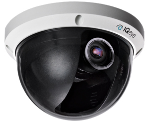

http://www.iqeye.com/products/alliance-series/alliance-pro.html
And honestly, the IQs are a little on the spendier side... but I'd take them over an Arecont any day of the week (and twice on Sunday). I've installed quite a few of both, rarely had an issue with any IQ (and when I did, IQ's support was outstanding), and frankly, the IQ's are just a lot easier to install and configure. The Alliance dome's mounting design is brilliant and completely unique from any other domes I've worked with.
Can those IQ Alliance interior domes be retrofitted to be used outdoors?
It looks like you could add a IQAE-BOX and use an interior model outdoors.
Matter of fact, all the A11s we've ever got in have come with the back-box, and yes, I have installed them outdoors on a wall in direct weather.
