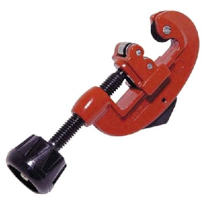

rkninc 0 Posted February 12, 2012 For EMT pipe what do you cut it with at the job site? Share this post Link to post Share on other sites
SDM Group 0 Posted February 12, 2012 Cut it with a hacksaw and reem the inside with pliers, conduit size is usually 3/4 fill of the wires Share this post Link to post Share on other sites

3RDIGLBL 0 Posted February 13, 2012 For EMT pipe what do you cut it with at the job site? We run so much emt I bought a 12v Porter Cable clamp saw and ream the cuts. I love the thing and use it all the time. Share this post Link to post Share on other sites
