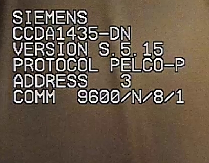

tomcctv 187 Posted February 22, 2012 One interpretation of this statement is that Lancillotto must only use the 4NSYS to control the CCDA1435. Fiona. read the posts then you might understand. and also look at the ops picture of PTZ settings (pelco_p) if the op uses the dome and the controller then yes they work together (BUT NOT ON PELCO PROTOCOL) the PTZ has most protocols in its menu including pelco-p pelco-d linil ....... the DVR also has PELCO. so DVR and PTZ are a match DVR ---- Siemens controller (no pelco) ------ PTZ = no data control unless a converter is added but its cheaper to change the controller DVR------pelco controller ------ PTZ = will work no problem. Thanks for your response.Ok for what concerns the control console in the Pelco dome. But why not work the dome instead Siemens CCDA1435-DN is able to use the protocol PelcoP as DVR that should command it? Speed, protocol, connection and id are correct, because it does not work? Share this post Link to post Share on other sites

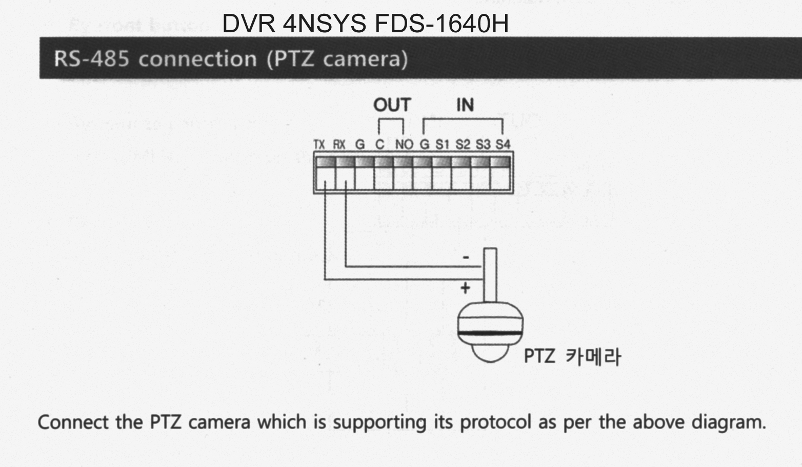

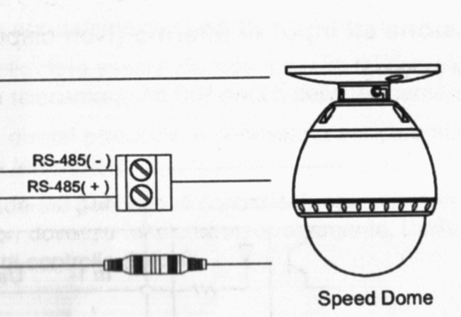

Lancillotto 0 Posted February 22, 2012 ....So you are saying that: (i) you have tested the 4NSYS on another Pelco D speed dome and it works. (ii) the 4NSYS still does not work with the CCDA1435 though they are both set to Pelco D? Yes is correct ...however the siemans PTZs are old and need to be terminated but another problem is the domes dont have a termination switch so either the siemans termination box needs to be fitted to each dome or a resistor needs to be put in place.... I tried with and without resistance This is DVR connector: This is Speed dome connector with DVR work fine This is Siemens CCDA1435 Speed Dome camera connector that does not work with DVR I exhaustive ? Share this post Link to post Share on other sites

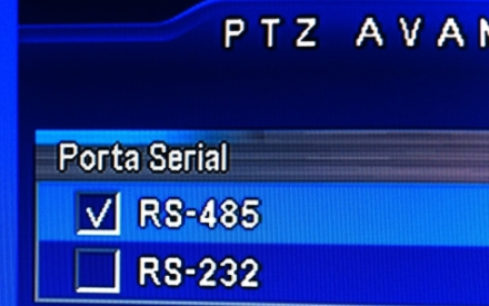

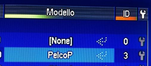

Horizon 0 Posted February 22, 2012 Hello Lancillotto. Could you please go to the DVR's PTZ Setting page (Call the Menu -> Camera -> PTZ Setting) and check that the: Camera model is Pelco-P, Camera ID is 3 Also please check that you have RS-485 ticked in the "PTZ Advanced" page, otherwise it will use RS-232. Share this post Link to post Share on other sites

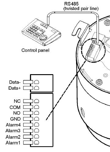

Fiona 0 Posted February 23, 2012 Lancillotto, the CCDA1435 uses a RS485 Termination Switch on the rear of the dome drive - next to and just above the BNC input. See diagram and my arrow below. Please take a look at it on your CCDA1435 This switch should be set to the ON POSITION. Share this post Link to post Share on other sites
Lancillotto 0 Posted February 24, 2012 Lancillotto, the CCDA1435 uses a RS485 Termination Switch on the rear of the dome drive - next to and just above the BNC input. See diagram and my arrow below. Please take a look at it on your CCDA1435 This switch should be set to the ON POSITION. I had already first time tried in off and on position I had already written... ...however the siemans PTZs are old and need to be terminated but another problem is the domes dont have a termination switch so either the siemans termination box needs to be fitted to each dome or a resistor needs to be put in place.... I tried with and without resistance Hello Lancillotto. Could you please go to the DVR's PTZ Setting page (Call the Menu -> Camera -> PTZ Setting) and check that the: Camera model is Pelco-P, Camera ID is 3 Also please check that you have RS-485 ticked in the "PTZ Advanced" page, otherwise it will use RS-232. I do not know what else to try Share this post Link to post Share on other sites
