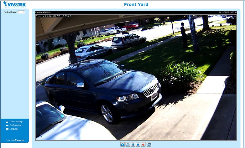

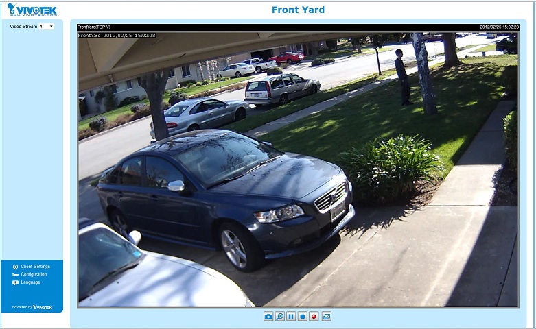

MaxIcon 0 Posted February 23, 2012 Thanks for the note! Good to hear some good words on the Vivotek's.. I'm current eyeing the IP8362 (bullet) and FD8362 (dome) which are very similar but the dome version has the SmartFocus system so no need to monkey around with focusing. The IP version does need some fiddling around in that area.. On thing that concerns me on any of these is how well they'll do with late afternoon sun in my backyard and whether it will result in an unusable image -- perhaps not as bad as I'm expecting since the camera will be mounted up under the eaves and will be pointing down a bit.. Not sure if bullets behave better in this situation over an equally mounted dome -- I'd think the dome would suffer more since it has no sun shade to speak of.. Hence my interest in one of both -- bullet for back, dome for front. Bright sun and heavy shade combinations are challenging to the older Vivoteks like mine (dunno if the newer models have WDR or similar); depending on what's centered on the screen, you either get washed-out highs or impenetrable darks. I've turned the contrast down on one and that's helped a lot, while the other only has this problem during a short period. It seems these cameras come with fairly high contrast and saturation as a default because it makes a well-lit scene look really good - crisp and sharp, bright colors, and much more life than an analog cam. Subduing these qualities helps the balance a lot, but probably doesn't sell cameras as well. I've got one in a similar situation - under an eave, looking into the backyard where the sun gets pretty bright at times. Let me see if I can grab a few screenshots this weekend. Share this post Link to post Share on other sites
camera-newbie 0 Posted February 23, 2012 I've got one in a similar situation - under an eave, looking into the backyard where the sun gets pretty bright at times. Let me see if I can grab a few screenshots this weekend. Cool! Thad' be great! I'm hoping if I can put it up at the peak of the roof and have it pointing down into the yard that angle may help to keep some of the sun out if I'm using a bullet -- worst come to worse, perhaps an extra sun-shield could be fabbed up to extend the factory cover by an inch or two depending on whether that impedes its view of the yard. Share this post Link to post Share on other sites
MaxIcon 0 Posted February 26, 2012 OK, here are some screen grabs (half-size, with a link for the full size). This is the IP8332, which is 1MP, and it's running H.264, 10fps, "excellent" quality. I may change from H.264 to get the view a bit crisper, and I'm currently running contrast at -5 to resolve the mid-day shadows best. Taking these grabs reminded me of why I like the Vivoteks so much. The web control is very fast and flexible, and I can change parameters and go back to screen views very quickly, compared to my other cams. They've been among the most reliable as far as connections go, too. Brightness, Saturation, Sharpness are all set at 0, and contrast is adjusted in the pics below. My assistant is standing in the shadow of the tree, about 35 feet out, and you can see the shadows at the car show a lot more detail than the more distant shadows. The camera's up under the eaves, as you can see. Contrast +3: http://maxicon.com/cctv/vivotek/viv-ip8332_front_contrast_+3-2.jpg Contrast 0: http://maxicon.com/cctv/vivotek/viv-ip8332_front_contrast_0-2.jpg Contrast -5: http://maxicon.com/cctv/vivotek/viv-ip8332_front_contrast_-5-2.jpg Share this post Link to post Share on other sites
