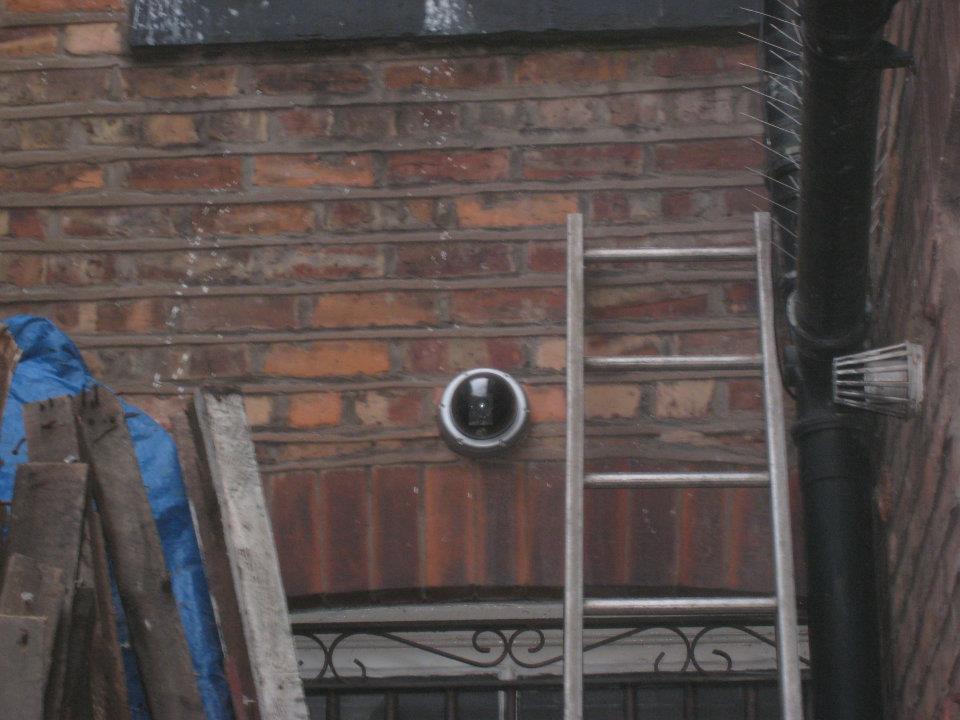

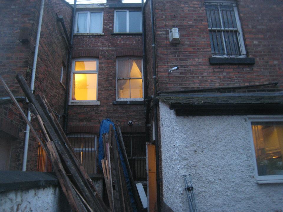

i have a camera mounted on the house looking at my back gate which is about 6 meters away. it is zoomed right in but because the compression of my DVR is so rubbish, i would like it to be zoomed in more so i can get better shots of faces.
the current lens in the camera is 12mm focal length. i am not aware of any auto iris lenses for board cameras with a higher focal lengh which means i will have to use the lens of a box camera.

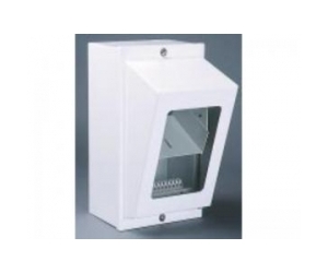

i would use a box camera with lens but i don't really want a big housing hanging off my home.
i have a small(ish) housing that would fit a board camera and 'box lens' so basically i need a way of fitting a big CS mount lens onto the small thread of my board camera, and a way of connecting the iris.
is this even possible? if not, what do you suggest? i did think of using a camera that has digital zoom. but i don''t have one and don't want to shell out for one.

i think i may just have to resort to using a massive housing
