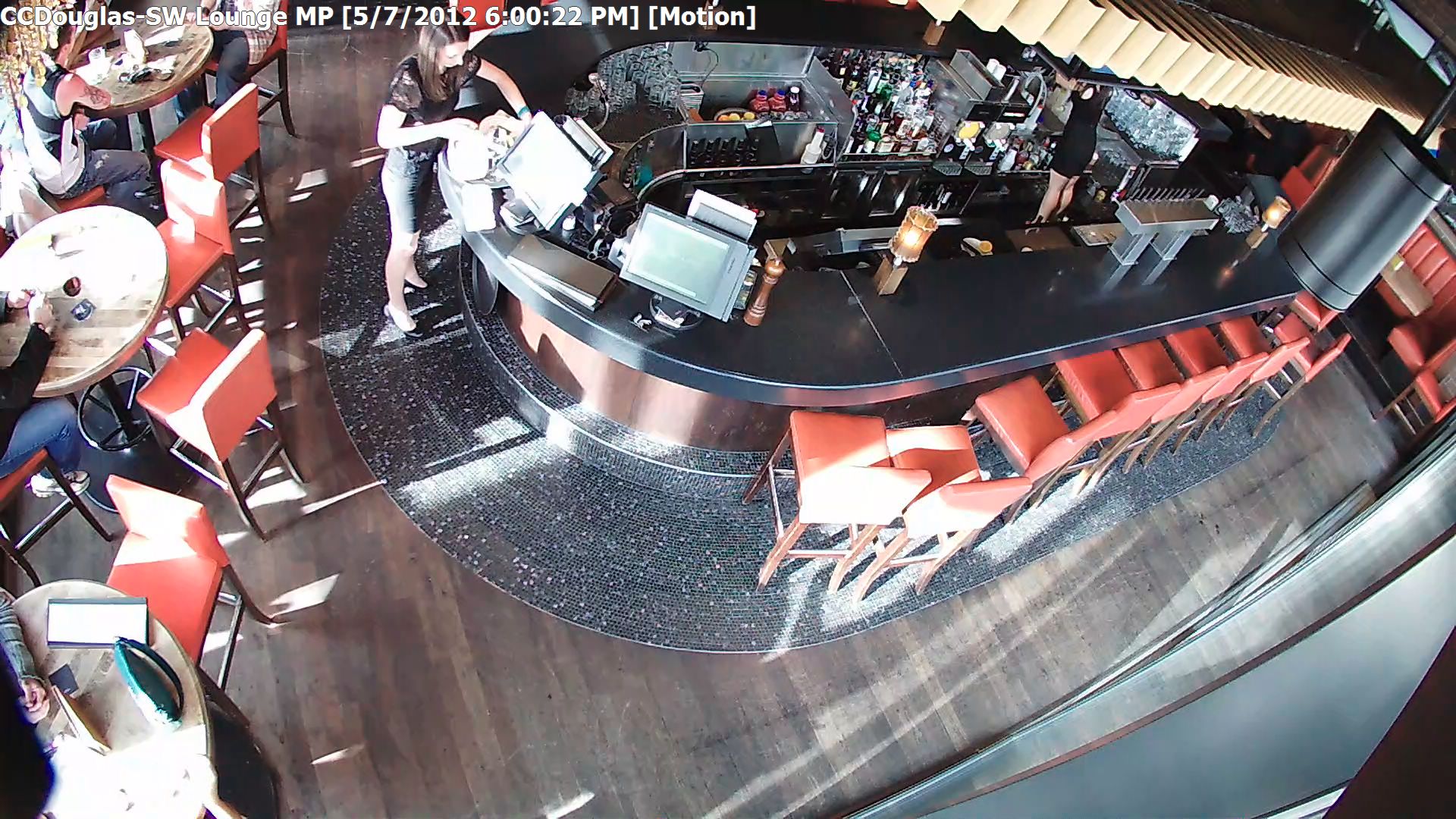

About your 8162P, that shot looks nice! What software/DVR are you using with that?
