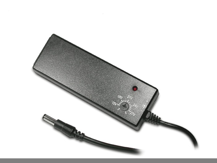

tomcctv 189 Posted June 6, 2012 hi something to always carry around is a verible power supply. we use these good for 12v over long runs 1.500ft Share this post Link to post Share on other sites
