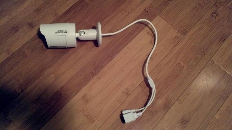

NotSoSimple, is there a recomendation in the manual or from the company as to how to make that weathertight? I wouldn't worry about moisture getting in the wire, but I can see the copper corroding inside the RJ45 connectors. I would have expected a weather tight seals like in the connectors used under the hood of a car. Or are they expecting that you run the connector in the wall and then plug your Ethernet cable into it while indoors?

I have quite a bit of experience with non-weather proof RJ45 connections used in outdoors locations. The best solution I've found yet is to just spray the connection with CorrosionX:

Short of leaving the cables in standing water, this works excellent.
Do you spray the RJ45 jack and plug seperately, or plug them together and spray the outside? Doesn't it get inbetween the connection and interfere? Just asking, don't know.

About the connectivity. In the base of the mount is where the wires come out. It has a pigtail about 15" long and then splits for the barrel jack (power) and RJ-45 (network). See below for a pic. So out in the open it would be rather susceptible to the elements. In my case I have enough freedom I think I will recess a single gang box into my sofet and just place the cable connections in there.
