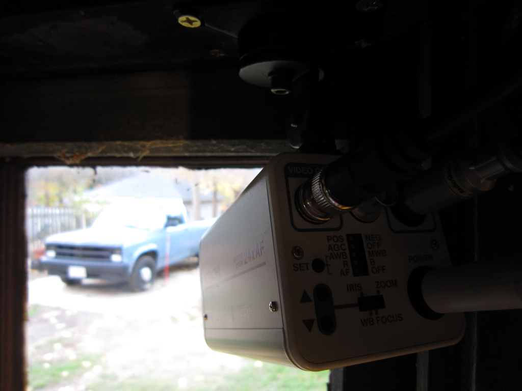

SO I tried the cheap cable, it works! I installed it with a staple gun and held it loosely so that the cable was snug but it could still be moved.

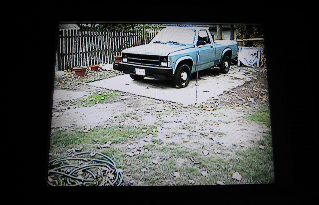

I don't really see any noise or interference however if you look really closely the highs/light spots have a very slight flicker, I couldn't even really call it a flicker it's so slight. However the highs are very blown out, if I manually control the iris then sunset and night won't be correct. Also when I switch my TV to it's coaxial input my camera does not always come up sometimes it takes a few seconds for some reason even though the L1 text/label is smaller then normal which indicates to me as if it's getting signal immediately but possibly it's weak?? Now I'm not sure if this could be the problem but I accidentally stapled through the wire pretty close between the core and shield so I'm thinking maybe a strand or two of the shield is touching the core, is there a way to rule this out maybe with a multi-meter?

For correcting the oversaturated highlights, try adding a 75 Ohm terminating resistor at the TV input. These type of cameras are designed to provide a 1.0 Volt peak to peak signal into a 75 Ohm load, which is what CCTV equipment provides. However, TV's often present a very high impedance load, allowing the signal voltage to go higher, and affecting the contrast in the image.

Yes, the terminators are just a 75 Ohm resistor in the connector under the cap. They don't have a composite (RCA type) connector, you would use it together with a BNC tee connector. If you can find a way to get a standard 75 Ohm resistor placed across the coax connector/cable at the TV, it will work fine as well.

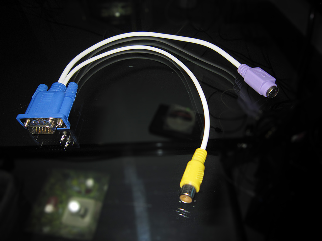

So I got fed up with the brightness and the lack of knowledge here...bought an adapter to connect the camera to one of my computer monitors (I only have 2 HDMI and 1 VGA input) so I bought this cable on eBay for $2
I connected the BNC to the composite with an BNC-to-Composite adapter and the monitor does nothing; no signal. So I tried going from BNC-Composite-SVIDEO then an SVIDEO cable from the adapter to the SVIDEO on the VGA cable...monitor would flash quickly something about the resolution it was hard to read. My monitors are 1920x1080 so I tried on a 17" 4:3 with no results!
No, that's the wrong adapter. That one looks like it's a break-out lead for a video card or something.
The composite video to VGA adapters I've seen are a box about the size of a pack of cards - like this randomly picked URL:

The one's I've used work okay, but you need to adjust the contrast and brightness each time it's turned on. It doesn't remember the settings.
That is quite the step up from $2 haha it must convert the signal/resolution I may just try one of these cheap PCI cards that support video input I have laying around.
Yeah, I think I paid about $30 for one (a bargin on a local auction site). It does have to capture the video, then upscale it to VGA (or Super VGA?), so there's a bit of smarts inside it.

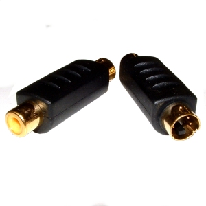

I have been thinking about just getting a capture card, deff a future possibility. What about this route...I only have two inputs on my TV and the other is an RGB so I can't use it for another composite camera, does anyone think I can use an RGB-to-Svideo adapter and then pair that with an Svideo-to-composite adapter??

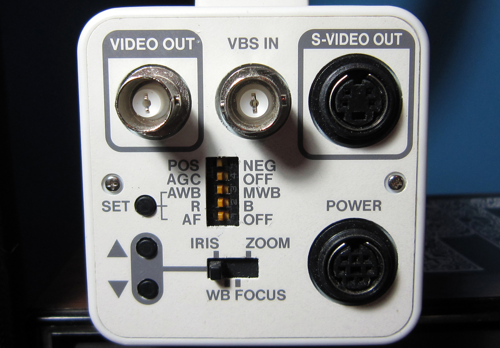

I have left all the settings on my camera to auto; left. I decided to play with them today but I do not know what "R" & "B" stands for? I made sure the zoom was all the way out but I really think the iris adjustment is not functioning correctly. When I set the toggle to IRIS and push up or down it does nothing, during the peak of the day the light areas are over exposed and during dusk the picture is very crisp and well lit so the iris must be stuck slightly over exposed which is better then slightly under exposed. Any clue if this camera works with IR flood lights? IR CCD?
