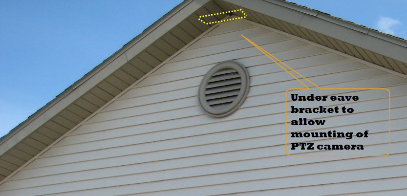

I'm wondering if any of you have found a source for a under eave mounting plate/bracket designed for a PTZ installation. I have several very nice under eave locations around my house that are perfect for mounting cameras, but have not found a bracket. I'd rather not mount right on the vertical face of the vinyl siding.
In short, it would be a small plate with "ears" that I can secure into the soffit. I've hunted all over with just about every keyword I can think of, so I'm assuming that I'll need to build one myself.

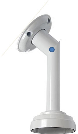

That sounds interesting too - thanks for the hint. I still wonder if something maybe like this exists:
The mounting foot would go under the soffit into plywood, and the pole would come out a single hole with the PTZ on the end. The blue dot indicates a hex head swivel joint.
Has anyone seen such an animal?
It would be VERY simple to just bend a steel pipe or a piece of rigid conduit to whatever angle you need and mount it up. I have even taken larger stuff (over 2 inches) to a muffler shop and had it bent by them to save myself from renting the tools. Just mock it up with a piece of cardboard and then take that cardboard and get it done.
