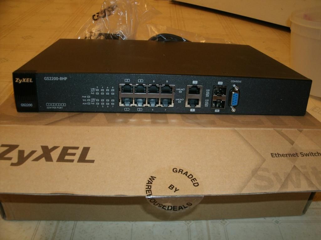

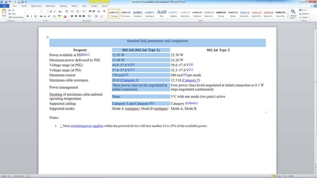

I bought a ZyXEL 8-Port Layer 2 Managed Gigabit PoE Switch (GS2200-8HP) that has four ports with 180 W of total budget power to port 1-4 with 30W each and to 5-8 with 15.4W each. My question is whether I can use the high power ports for any of the cameras and can I use the IR cameras on the 15.4W ports if I use a PoE splitter. I don't know much about electrical specifications - the issue is how to use the DVR, managed PoE switch, analog cameras, network cameras and come up with some kind of system that will work on a wooded lot to detect trespassers and vandals.
Will a 12V PoE Splitter work with the ports on the ZyXEL switch to power analog and network cameras?

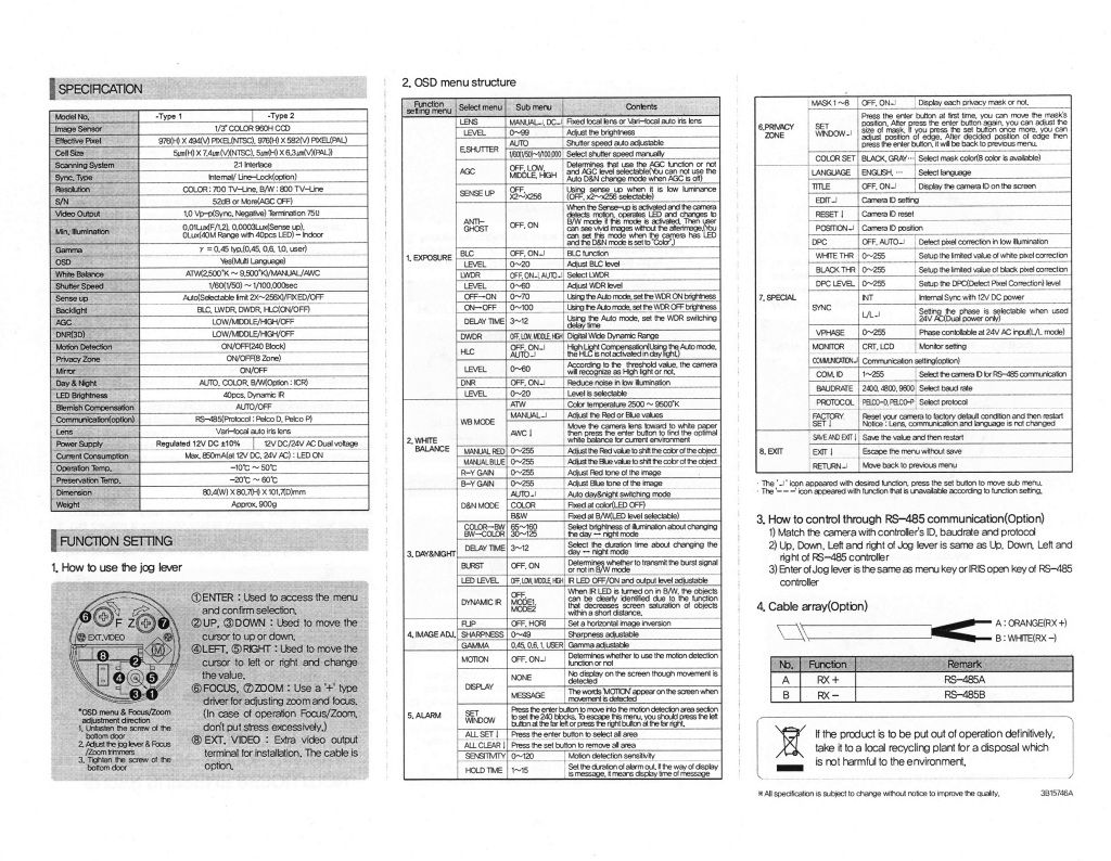

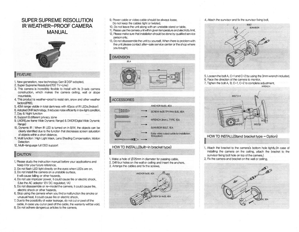

These are the cameras:
1. IR bullet cameras (4) can use:
a. 12V DC
b. 24V AC (±10%)
c. With max current of 850mA (LED on)
