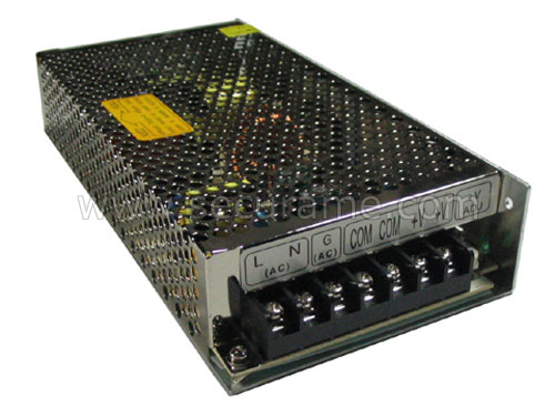

On cameras with very long cables maybe we need to turn up the voltage a little bit to make up for the voltage drop. If you look at the picture on this 12V 15A unit, you can see on the right of the black connectors there is a power led, and also a white knob for adjustment, right on top it says "+V adj".
Thanks for the info.I looked on our power supplies and ours are also adjustable.Adjusted them to 13.8 did the trick.Without your help we would of never of know as the manufacturer was of little help.Thanks again..we are still having a problem with one camera.May be a cable problem or port on the dvr just not sure yet.Thanks again.
