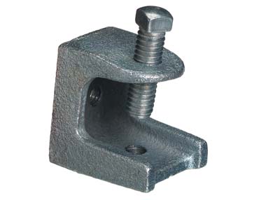

Anyone have any solution to mounting cameras to vertical I-Beams?
Can't drill into them so I would need something to clamp to it and that I can mount camera to....
Thanks....im not clear on that though....this would be a vertical I beam...
what would you do use 2 of those clamps to clamp camera flange to beam?
Use two of them and you use two 1/4-20 screws to mount the cameras to the beam clamps.
Would you have any pictures of that?
What are the clamps made of....you drill straight into the clamp....? I know you know what you're you're doing, but im just trying to picture that..the clamp looks kind of small for that
Thinking about this:
Do you mean remove the screw and put a 1/4-20 screw through one hole in the camera mount , through the clamp to the beam?
No the screw that is in it holds the clamp to the beam. There are 2 other 1/4-20 holes in the beam clamp which you would use to mount the camera too with screws.
but if that makes it a proper job then thats what id go for imho.
correct, but why wouldn't the other beam clamps do the proper job?
Don't expect the first beam clamps to hold against twisting weight or force. Electricians will typically use two of them, mounted on each side of an I beam with a piece of unistrut between the two. This keeps the clamps in position. They then mount equipment to the unistrut.
Ordinarily, advice would be to avoid mounting steel camera bracket direct to steel structural component. You could be ok, but could also develop a lot of problems.
Rather mount a nonconducting base to the steel and mount the camera to that.
