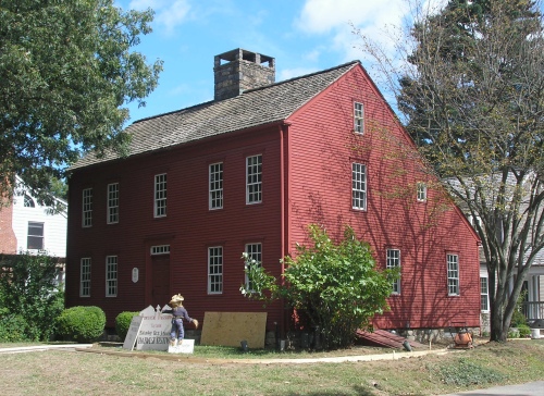

P.S. this is an example of a saltbox, we have a camera in the front under the eave aimed towards the door and walkway covering the approach to the front door. I'd like to be able to put the PIR under the eave too.
I have come across PIRs mounted in all sorts of weird configurations - some work & some don't. These are adaptive installations as the PIRs are not designed to be used in such ways. You could try mounting one towards the end of the house looking back at the door & use a "curtain lens"
