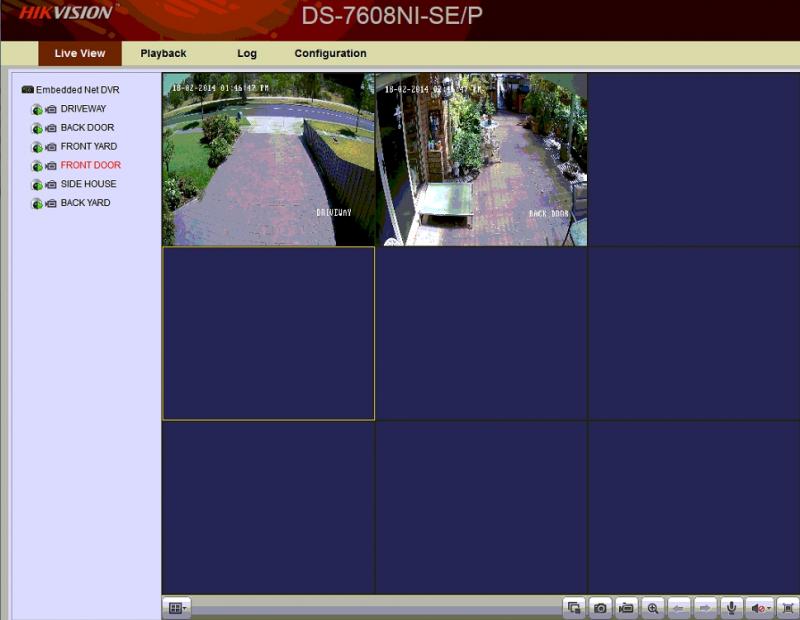

Here is a screenshot from outside the LAN, when I click start all, SOME cameras appear not all, sometimes I get 2 cameras, other times 3, but there should be 6.

Are you live viewing the main stream or sub stream? You need to have the bandwidth to view those remotely. Can you enable/disable one camera at a time to make sure at least they work first vs just letting it throw them all up at once.

Configuration -> Local configuration -> Stream type, set it to Sub stream. Your internet connection probably does not have enough upload bandwidth to stream all cameras at the Main stream at the same time.
It worked!!!! Thanks so much, I owe you a beer
