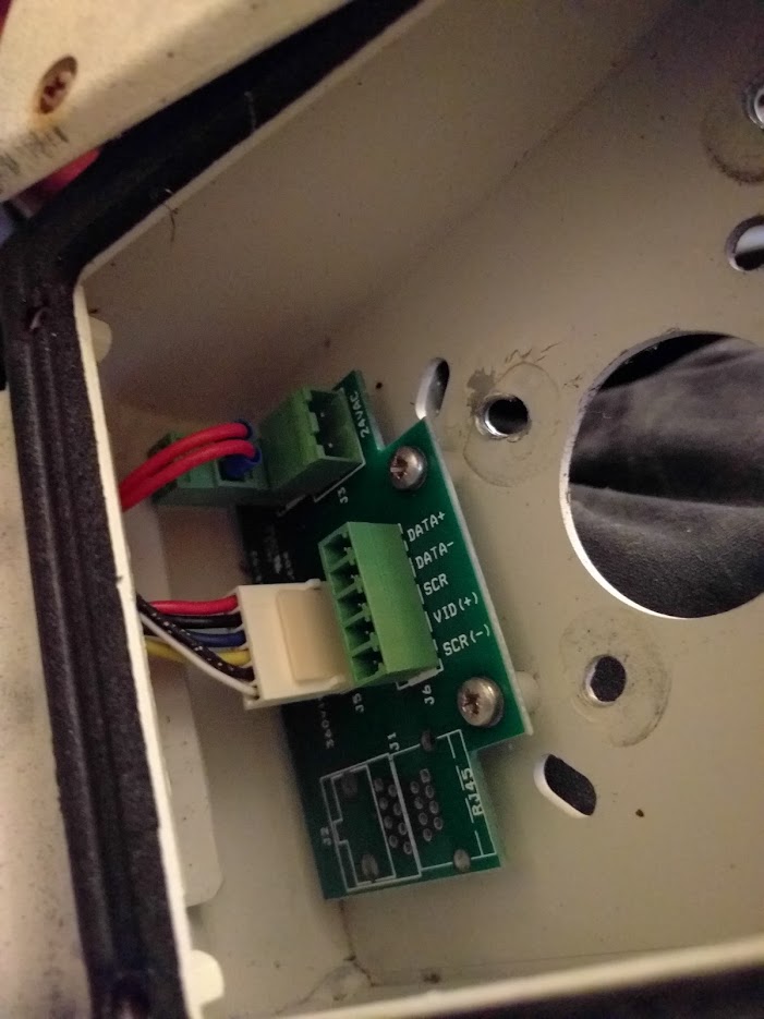

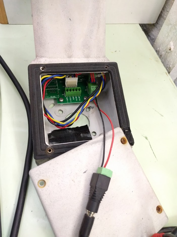

Image of inside the dome camera internals:

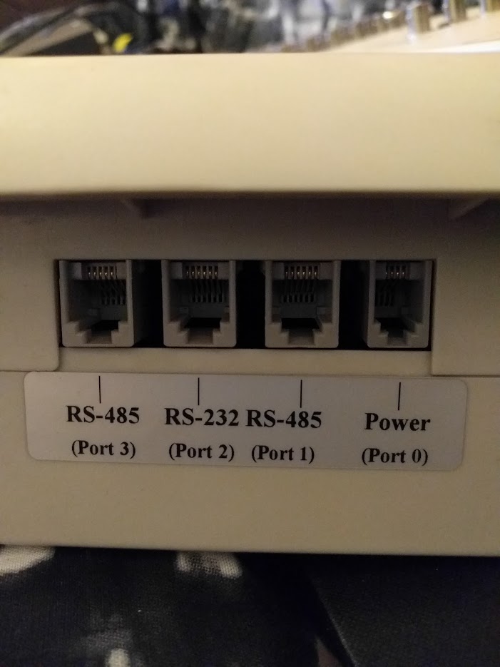

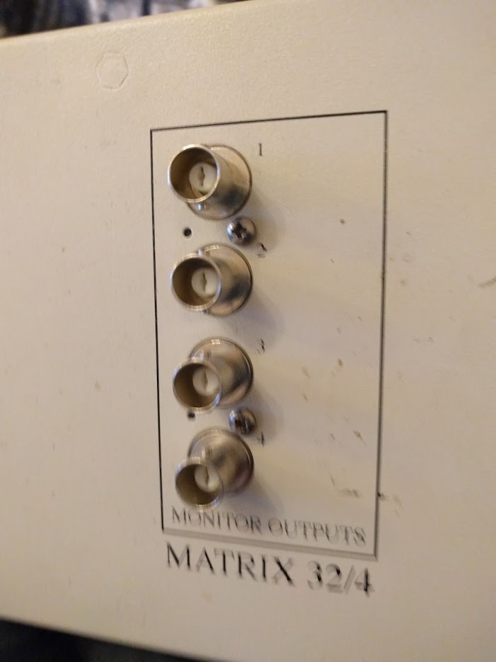

Image of the matrix?:
Scrap the matrix and keypad what wires go where on the dome camera?

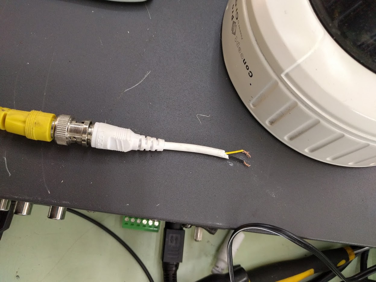

I've got 24v going to power and I've cut a bnc male from an old camera and it has two connections in it so I take it one goes on video or something and elsewhere on the camera then another two to the rj ports on the DVR itself?

So I've got a BNC connection coming from the DVR and just need to wire it to the camera I think???
I've got a connection of 24v power now to the camera unit itself...

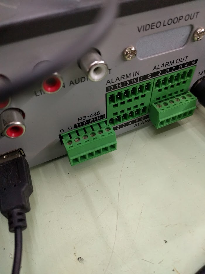

These are ports available on the rear of the DVR I assume I'll need to make some wiring from these to the camera base for PTZ control?
