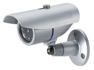

VS:

Specifications:
* Image Sensor: 1/4-inch Sony CCD image sensor
* Sensitivity: 0.3 lux F2.0; 0 lux (IR ON)
* Lens: 4.3mm F2.0 board lens
* Resolution: 480 lines of resolution!
* IR LED: 10 unit infrared LED
* IR Distance: 30 ft
* Dimensions: 49mm(H) x 82(L)mm, AC:49mm(H) x 105(L)mm

The Second one is 1/4" 4.3mm lens so thats about the same as the above for lens view.

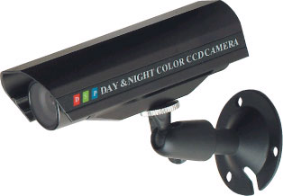

OK to hash this out some more, how does this look?
* 1/3" SONY CCD Image Sensor Day & Night
* 480 TV Lines High Resolution - 600 TV Lines in B/W
* 0 Lux with 48 IR LEDs on
* Weatherproof IP66
* Black Housing built in aluminum
* Range up to 90 feet
* Automatic IR triggers On under low illumination / Off under Normal Illumination
* Sun Shroud to reduce glare and dissipate heat
* Lens 3.6mm
* Up to 90 feet range
* 12V DC 1000mA (Regulated power supply is highly recommended)
* BNC/DC Jack
120 bucks with out power supply.
Initially CMOS chipset can preview "ok" image. but days go long, the problem start come like color turn yellow and image signal drop.
Never ever go fot CMOS even though it is cheap. It is not reliable.
for wide angle IR camera, just get a 1/3 sony and with 3.6mm standard lens. it fit your needs.
