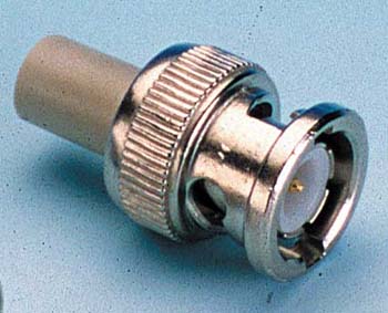

You can use coax cable, with the appropriate connector to the TV. I am assuming the DVR has a BNC for it's video output:
If your cable has the bnc on both ends, you'll need an adapter like this:
