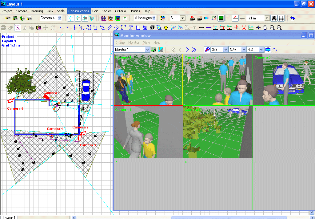

Exact sizes are needed for modeling your task with VideoCAD.
There can be a lot of variants. Camera locations, heights of installation, quantity, lens parameters, image resolution are critical! To get the best variant you should see on project stage what you will get in result. And think as a intruder....
For example: I can suggest to move cam A and cam E to expand control area to the left and to watch back door from two sides.
May be cam E is unnecessary there. It can be moved to the left wall. Cams A and B are not guarded against damage from the left.
Cam D should be moved to the lower-right corner. On the corner it will control more wall area and will be guarded by cam A.
4 cameras are preferable for one monitor. You can place 4 image on one square-screen. Or use 3x3=9 cameras or 2 screen with 4 cameras.
See image. But it is example only. It is impossible to design CCTV system using only location plan. Download this illustrated article for details http://cctvcad.com/Files/the_principles_of_cctv_design_in_videocad_part1.pdf
Hmm. not a bad idea. and i thought about that, but if i move cam E to the right side of the door, then itll be mounted on the "1 story" side of my house, and somebody could reach it. where i have it now, itd be hanging from the 1.5 level side, about 15 feet up, out of reach

Alpine0000, you are right. You have necessary information for your design
Camera defence is important too. A lot of things are critical for CCTV design. Some of them are relative, some contradict one another
Camera height of 1.5-2.5 meters provides maximal face recognition area but by defence reason the height should be higher. However you can use vandalproof camera, mured, hided, pin-hole cameras.....
But pin-hole cameras have low light sensitivity...
More field of view provide more covered area, but less recognition area. and so forth.
Good design is a compromise. Camera image models on design stage are very helpful for right choice.
