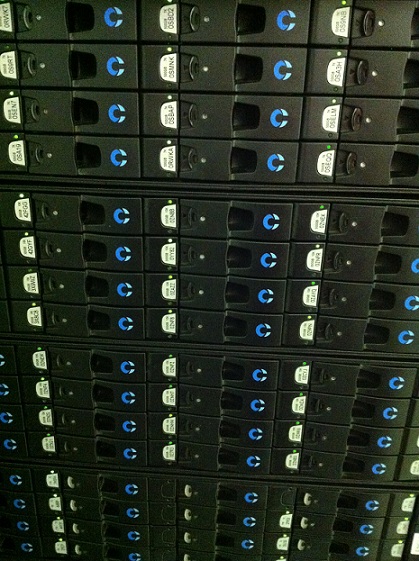

I looked into that DS1812+ as well but the price was almost the same as a traditional 2U NAS with redundant architecture. Then again I'm not sure why I need redundancy... until I think about my days managing walls of these:
